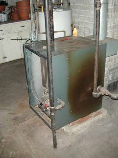

"We haven't had decent heat since that heating contractor left our basement."
She was about as angry as any homeowner who had ever called me. "We paid good money for that new boiler," she continued, "but we still have uneven heat throughout the house, just like we did before. And it sounds like the hammers of hell are pounding on the pipes, just as they did before. What do you think we should do?"
I felt her frustration, but I have to admit, my first thought wasn't about what she should do. I was thinking about what she should have done. You see, the way I figure it, the best time to discuss heating problems is when you're contracting the job, not after the job is finished.
There's an easy way to avoid the most common heating problems. All it takes is a good checklist, some negotiating skills, and the willingness to shop for the best value rather than the lowest price.
Here's some advice I'd give my best friend if she were shopping for a boiler.
