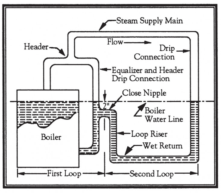

Q: What the heck is a Hartford Loop?
A: It’s an arrangement of piping between a steam boiler’s header and its gravity-return piping. The end of the header drops vertically below the boiler’s water line, and connects into the bottom of the boiler. We call this pipe the “equalizer” because it balances the pressure between the boiler’s steam outlet and condensate-return inlet. The “wet” gravity return line, which returns the condensate from the system, rises up from the floor to join with the equalizer at a point about two inches below the boiler’s lowest operating water line.

Q: How does the Loop work?
A: If a return line breaks, water can only back out of the boiler to the point where the wet return line connects into the equalizer. The Loop works like a siphon that runs out of water. The point where the Loop connects to the equalizer is higher than the boiler’s crown sheet, and that’s what provides the safety. Since the water couldn’t instantly vanish from the boiler, it bought the Dead Men some time to notice the problem and save that wood- or coal-fired boiler. The piping arrangement wasn’t fail-safe, but it was a vast improvement over the old way of returning condensate directly into the bottom of the boiler.

Q: Why does the Loop connect into the equalizer with a close nipple?
A: Steam rises up through the equalizer, just as it does through the boiler sections. When the relatively cool return water meets that steam at the close nipple, the rising steam bubbles quickly condense. Naturally, the return water rushes in to fill the void left by the collapsing bubbles, and this creates a slight water hammer inside the tee connecting the return to the equalizer. If you use a long nipple instead of a close nipple, the returning water will have more room to move, so it creates more water hammer through its inertia. Long nipples acts like gun barrels in this case, and you should always avoid them. Stick with a close nipple, or use a “Y” fitting.
Q: How far below the boiler water line should I connect the close nipple?
A: Generally, it should be two inches below the bottom of the gauge glass, but check the boiler manufacturer’s specs on this. The centerline of the close nipple has to be below the water line, but above the boiler’s crown sheet.
