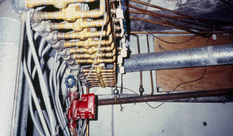

I have this delicious photograph someone sent me years ago. It shows a rather large boiler in an apartment building. A thick pipe leaves that boiler and enters a manifold that feeds 15, 3/4” zones, each with a zone valve.

“Dan,” the sender wrote. “I have a serious problem and maybe you can help. I’m sending you a photo of the boiler and the piping that I installed.”
I looked at the photo again and noted that the circulator was one that Bell & Gossett called Little Red. That circulator was indeed both little and red.
“Dan,” he continued, “when I’m running just a few zones, everything is fine. But when I try to run all 15 zones at the same time, most of them don’t get hot. The tenants are complaining. Do you think the boiler is too small? I didn’t do a heat-loss before I put in the boiler. I sized the new boiler by what was there before. I don’t know what to do now. Help!”
Clearly, he didn’t have enough flow, and since heat travels on the flow like a passenger on a train, he didn’t have enough heat at the radiators. I asked him why he had used that tiny circulator and he told me he had taken it off another boiler because his customer didn’t care for the color red. The contractor didn’t want to waste the circulator so he used it on this job instead. Waste not, want not, right?
I asked him if he remembered that scene in Jaws, when they realize they’re going to need a bigger boat.
“Yes.”
“You’re gonna need a bigger pump.”
He asked how much bigger and we sized it together. And then he asked me who was supposed to pay for that larger pump and I told him that he was because he is the contractor and the contractor is supposed to know more about heating than the people who hired him.
He thought that was terribly unfair.
