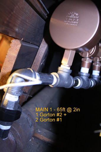

First, vent the mains quickly. This will help the steam get to all the radiators at about the same time. Steam is a gas and it will always look for a way out of the system. When it leaves the boiler, it heads toward the air vents. The bigger the air vent, the more inclined steam will be to head that way. If the system heats unevenly, install a good, high-capacity main vent near the end of the each main and watch the difference it makes. Pipe the vent about a foot inches back from the end of the main, and six-to-ten inches up on a nipple to keep it away from any end-of-main water hammer. If you can’t get these exact dimensions, do the best you can. And remember, the bigger the hole, the faster the venting, so it pays to install a tee with a three-quarter-inch tapping for the vent near the end of the main. Don't try to get by with a tiny hole drilled into the main. Tiny holes don't allow air to vent quickly.
Install a “Y" strainer before the main vent. An old steam system can be plenty dirty, and since steam is moving at high velocity (up to 60 mph in a one-pipe system!), it picks up particles of rust and sediment. Eventually, this stuff winds up inside the main vent. Before long, your main vents won't shut. They’ll spit water and let steam pass to the atmosphere. This creates water-level problems back at the boiler. A "Y" strainer, installed vertically before the main vent can protect the vent from system debris and increase its life. Use the strainer as part of your six-to-ten-inch elevation for the main vent and you'll improve the system's performance dramatically. Then make sure someone cleans the strainer from time to time.
