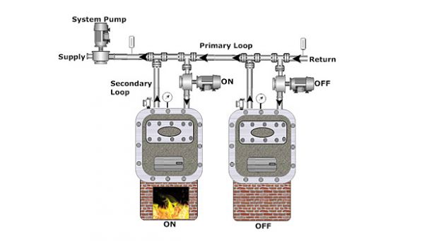

While I do not wish to weigh in on the benefits or losses of jacket loss, the International Energy Conservation Code believes it is something that should be addressed. The code stipulates that boilers should either be piped with primary/secondary piping or use an isolation valve that limits flow through the idle boiler.
primary secondary solution to reducing boiler jacket loss
In a primary/secondary system (above), each boiler has its own pump. If the boiler is idle, the pump will not operate. This will eliminate the water flow through the idle boiler. The pipe connections to and from each boiler must be no more than 12 in. apart on the primary loop. This isolates the boiler from the hot system water. It is the most common piping arrangement now, preferred by most boiler manufacturers. In addition to increased system efficiency, it assures proper flow for each boiler as each has its own pump, properly sized for the correct gallons per minute.

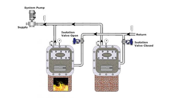

Isolation valve solution to reducing boiler jacket loss
The other option in the energy code is to use isolation valves (above). A few factors should be considered when these are installed. The first is flow. When one boiler is off and is isolated from the system pump, all the flow will go through the boiler that is firing. This flow could be excessive and may be greater than the manufacturer recommends.
Remember, the system pump is sized to distribute the heat from all the boilers, plus a safety factor. The velocity of the water could be high enough that the boiler will not be able to give up its heat into the water. This could be very expensive as the boiler will lose its efficiency. A quick check of the temperature rise across the boilers will tell you if this is happening. Most boilers are designed for a 20° F temperature rise from the return to the supply when firing. If the temperature rise is low, the heat is not being transferred into the water. Make sure to check the temperature requirements of the boiler manufacturer.
Another factor to consider when using isolation valves is that the limit controls may trip and the building will be without heat until the reset button is pushed. When the burner shuts off, the internal boiler components will continue to generate heat for a short while. Since there is no flow due to the closed valve, the internal boiler temperature will continue to climb. I have witnessed temperatures rises of 30° or more when the flow is shut off on a recently ended heat cycle. In many instances, this will be enough to trip the safety limit switch, which would be a manual reset-type of switch.
If using an isolation valve, a time delay should be used that will not allow the isolation valve to close until the temperature stops rising. This is usually 10 to 20 minutes after the burner shuts off. A time delay also should be considered for steam boilers if isolation valves are installed on them. A vacuum breaker may be required as well if the boiler will be isolated from the steam system and allowed to condense.
