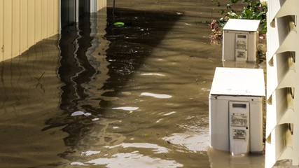

flood air conditioning unit
The devastation caused by a flood is terrible. The effects last for months, if not years, and the toll on the flooded area is catastrophic. During the cleanup and recovery, the first rule is DO NOT MAKE A BAD SITUATION WORSE!!!
  • DO NOT attempt to relight ANY combustion equipment that has been flooded. That includes water heaters, furnaces, boilers, pool heaters, gas fireplace inserts, dryers and any other gas or oil-fired equipment. Fire, explosion or other additional property damage can occur. Fresh or salt water makes NO difference. The units MUST be replaced*.
