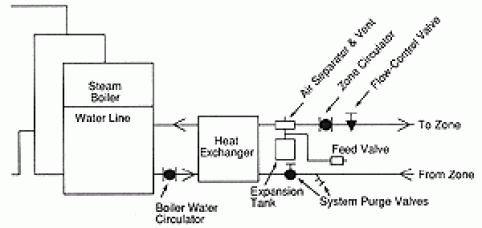

Q: Is it possible for me to use the condensate in a steam boiler to make a hot water zone?
A: Sure! Heating professionals have been doing this for years in areas such as New York City where there's still a bodacious amount of steam heat.
Q: Do I need a water-to-water heat exchanger to do this?
A: You could use a water-to-water heat exchanger or the boiler's tankless coil if you'd like, that will give you a first-class installation. However, if you follow a few simple piping rules, you can get the job done without the heat exchanger.
A: You'd set it up much the same way you would any hot water system. The water-to-water heat exchanger would become the "boiler" for your hot water zone.hot water zone off a steam boiler
Pressurize the new zone with an automatic feed valve and a properly sized compression tank. Wire the circulator to come on at the call of the room thermostat. Have it pump away from the compression tank and toward the radiation. You'll also need a second circulator to move water from the boiler to the heat exchanger. Wire this one so it runs at the same time as the zone circulator.
Q: Is it absolutely necessary for me to have that second circulator between the boiler and the heat exchanger?
A: The system works best if you do, but you could also let hot boiler water circulate through the heat exchanger purely by gravity. If you do it this way, however, the system's response to a call for heat won't be as fast as it would be if you use the second circulator. That second circulator pays for itself in system performance in no time at all.

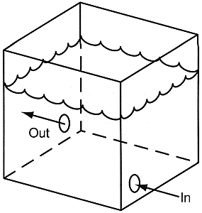

A: The main drawbacks is you need full-size tappings in the boiler. The size you need is typically 2" and the trouble is most modern steam boilers don't give you many extra tappings, let alone 2" ones.
Q: What happens if I use a smaller boiler tapping?
A: The resistance to flow through the heat exchanger will be greater so less hot boiler water will flow through the heat exchanger. Less flow means less heat transfer. You may not be able to get enough heat up to that new zone.

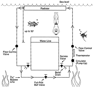

Q: Does the hot water radiation have to be lower than the steam boiler's water line?
A: No. If you're using a heat exchanger, your compression tank will keep the system under pressure. The fill pressure and tank size determine how high you can place the radiation above the boiler's water line. The only limit is the working pressure of the equipment you're using. It takes 1 psig water pressure to raise water 2.31 feet straight up. So, if you have equipment rated for, say, 100 psig, you'll be able to lift water about 230 feet to a hot water zone - if you ever wanted to (I don't think you'd ever want to, do you?). Let me put it another way - that two- or three-story house won't be a problem.
Q: Suppose I decide I don't want to use a heat exchanger, will my radiation have to be lower than the steam boiler's water line?
A: No, if you use 3/4" supply and return piping, and make sure you don't use any air vents whatsoever in the zone piping , the radiation can be as high as 30 feet above the steam boiler's water line.

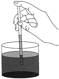

Q: What keeps the water up there in the zone piping if there's no automatic fill valve or compression tank?
A: Atmospheric pressure. It's the same phenomenon which keeps water in a straw when you put your finger over the top end and lift it out of a glass of water.
 heating p160 227x300
The water tries to fall out of the straw, but the atmospheric pressure (the weight of the air) pushes it back up. Since no air pressure can get into the top of the straw to balance the air pressure at the bottom of the straw, the water just hangs there.
Q: But a 3/4" pipe is wider than a straw. Won't the water fall out of it?
A: Not unless air gets up into the zone. The principle is the same, regardless of the width of the pipe. At sea level, the atmosphere pushes down on everything with a pressure of 14.7 pounds per square inch. One pound per square inch can lift water 2.31 feet straight up, so, if you have a pipe that's sealed at the top and completely filled with water, the atmospheric pressure will be able to support a column of water about 34 feet high (14.7 psia X 2.31 feet = 33.957). It has to do with pressure, not the width of the pipe. Get it?

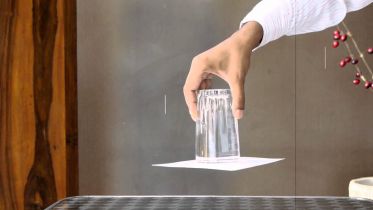

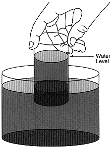

Q: I'm not sure. Can you give me another example?
A: Here, think about this. Suppose you were to lift an upended glass out of a bucket of water.
heating p161 224x300
The water stays in the glass because the atmospheric pressure pushes it up there. The glass is certainly wider than a straw, but since air can't get into the top of the glass to offset the pressure at the bottom, the water stays where it is. For practical purposes in your hot water zone, you can raise water 30 feet (or about three stories) and make it stay up there.

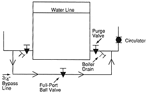

Q: So how can I fill the zone with water if I can't vent the top?
A: Set it up as a loop system and fill it with a garden hose.
heating p162a 300x190
Pipe in two ball valves (or gate valves) and two boiler drains below the boiler water line. Shut both ball valves (or gate valves). Now connect the garden hose to one of the boiler drains and let the other flow freely to a drain. Fill the zone piping under city water pressure until all the air comes out. Then, shut off the discharge boiler drain and the inlet boiler drain (in that order). Now open the two ball valves (or gate valves). If you did a good job of soldering, the atmospheric pressure will keep the water up in the zone.

Q: If I'm not using a heat exchanger with a compression tank will there be any pressure on the water that's in the zone?
A: There won't be any pressure at the top of the system. There will, however, be pressure on the water further down in the zone.

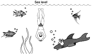

heating p163 300x178
Want another example of static pressure? Think of the water in the ocean. There's no pressure at sea level, but as you dive deeper and deeper, the pressure increases because there's more water sitting on top of you. In our zone, "sea level" is the high point.

Q: How hot will the water in my steam boiler usually be?
A: It depends on the steam pressure. The boiling point of water increases as the pressure on top of the water increases. For instance, if your steam boiler operates at 2 psig pressure, the water in the boiler will boil at 219 degrees F. If you run the boiler pressure up to 5 psig, the water won't turn to steam until the temperature reaches 227 degrees F. At atmospheric pressure (which is what you have at the top of the system), water boils at 212 degrees F.
Q: How does this affect the operation of my hot water zone?
A: If you're not using a heat exchanger and a compression tank, the water at the top of your zone can boil if it gets too hot.
Q: Will this be a problem?
A: It sure will! When water boils, it "flashes" into steam and increases in volume about 1,700 times. It does this instantly and, in a sealed "container" such as a piping system, with great violence. "Flash" steam is potentially very dangerous. It could actually blow soldered joints apart.
Q: When is this likely to happen in my hot water zone?
A: When the zone circulator shuts off.
Q: How come?
A: The water usually can't flash to steam when the circulator is on because the circulator adds a certain amount of pressure to the water. That extra pressure can keep the water in the liquid state. However, when the circulator shuts off, its pressure disappears and that's when the water at the top of the zone can flash into steam.
Q: Can this happen if the zone is lower than the boiler water line?
A: It's possible, but it's not likely because the higher water level in the boiler puts a certain amount of static pressure on the zone.

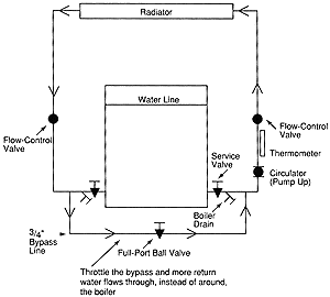

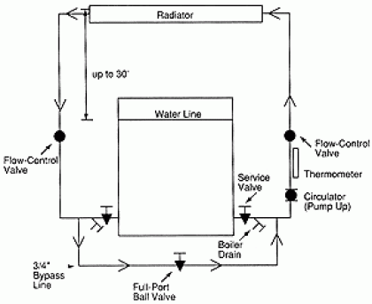

Q: Well then, how can I make sure the water at the top of the top of my system never flashes into steam?
A: By making sure the water entering the zone never approaches 212 degrees F. The simplest way to do this is to blend a portion of the water that's already been through the zone with the hot supply water leaving the boiler.
heating p165 300x146
Q: Do I need special valves to do the mixing?
A: Not at all. All you need is a 3/4" copper line between the zone return and the inlet side of the circulator, a 3/4", full-port ball valve and a thermometer. Pipe the ball valve into the bypass line and leave it fully open when you first fire the steam boiler. Next, let the boiler come up to steam pressure, and then start your circulator. With the bypass ball valve fully open, nearly all the water in the zone will bypass the boiler because it's easier to go through the bypass than it is to go through the boiler. That's the path of least resistance. Now, to make the water flowing into the zone hotter, all you have to do is throttle the bypass ball valve a bit. Keep you eye on the thermometer as you do this. You'll see the temperature rise very quickly.
Q: Why does the temperature go up?
A: When you throttle the bypass ball valve, some of the returning water finds it easier to flow through the boiler than it does to go around the bypass.
heating p166 300x270
When this hot water comes out on the other side, it mixes with the water that bypassed the boiler and gives you a mix that's hotter than the return water, but cooler than the boiler water.
Q: How much water should I let through the boiler?
A: The flow in gallons per minute isn't crucial here. Just keep your eye on the thermometer on the line supplying the zone. Stop blending when it reaches 180 degrees F. Then, take the handle off the ball valve so no one else can mess with it. This will be the hottest water the zone will ever see.
Q: So as long as the supply water going up to my hot water zone never reaches the boiling point, it can never flash into steam?
A: That's right. You've set a fixed limit on the temperature by mixing the return water into the supply water while the boiler was making steam at its pre-set pressure.

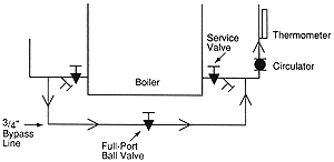

Q: Does it matter whether the circulator pumps away from the boiler or toward the boiler?
A: It's better to pump away from the boiler.
Q: How come?
A: Since this isn't a pressurized system, there's always the possibility the water can flash to vapor inside the circulator if the pressure drops too low when the circulator comes on. Technically, this is called "cavitation" and it can destroy a circulator in no time at all.
Q: Why does the pressure drop when the circulator comes on?
A: Because the circulator throws out what's inside of itself. This causes an immediate drop in pressure at its suction. This centrifugal action is what makes the water flow into the circulator in the first place. The trouble starts when there's not enough pressure behind the water flowing into the circulator to keep it in a liquid state.
Q: So the circulator itself can change the boiling point of the system water?
A: In effect, yes. It can change the boiling point of the water that's entering the circulator. And keep in mind, you don't have much pressure to work with on these jobs - just the height of the water in the boiler above the circulator. And then there's the pressure drop of the piping between the boiler and the circulator to consider. If you start off with a limited static pressure (the height of the water in the boiler) and then lose a portion of it to friction in the approach piping, it may be difficult to control things. That's' why it's best to pump away from the boiler. By keeping the circulator close to the source of the pressure (the water in the boiler), you lessen your chances of having problems.
Q: Does this apply to one case more than another?
A: It's especially important for those zones where you have all the radiation and piping below the boiler water line. If you have the circulator on the return, the pressure drop through the piping can cause the boiling point to drop. Combine this with a high starting temperature (which you'd have if the steam pressure were high and if you decided not to use that bypass blending valve) and you're asking for trouble. In the case where you have the zone radiation and piping above the water line, the circulator location isn't as critical because you have the static pressure of the water in the zone working in your favor. It's good to get into the habit of putting the circulator on the discharge side of the boiler, though. That way, you'll always be in good shape, whether you're piping a condensate zone, or any hot-water zone. Circulators always work best when they're "pumping away."

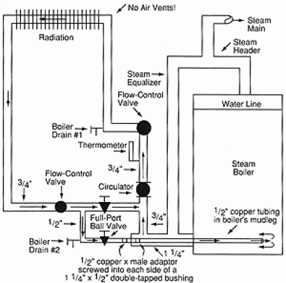

Q: Suppose there's no way I can tap directly into the boiler. Does that mean I can't zone with condensate?
A: You can still do it, but you have to use a bit of creativity. Here, just follow this diagram.
heating p170 300x297
Since you can't tap directly into the boiler, you'll use the 1-1/4" tee at the bottom of the steam equalizer line as both a supply and return point. Take a 1-1/4" X 3/4" tee and screw a 1-1/4" X 1/2", double-tap bushing into it. Next, solder a length of 1/2" copper tubing to a C X M adapter and screw that into the boiler side of the bushing. Now, screw another C X M adapter to the other side of the bushing. That's your return tapping. The copper tubing reaches deep into the boiler's mud leg and deposits the cooler return water on the side opposite the one from which you'll be drawing your hot supply water. You'll take the hot supply from the bull of the tee. By doing it this way, you'll get the circulation you need across the boiler to pick up the heat for the zone.
Q: Do I still need a bypass line if I pipe it this way?
A: Yes, the bypass allows you to temper the water as it leaves the boiler. The bypass keeps the water from flashing steam when the circulator shuts off.
Q: How do I start this one up?
A: Fill the zone with water by using the two boiler drains. Put a hose on #1 and purge back through #2. Let the boiler steam, and then start the circulator. Use your two ball valves to blend the water through the bypass until your supply temperature reaches 180 degrees F. Take the handles off the ball valves and you're all set.
Q: Before, you said I shouldn't pipe directly through the boiler's mud leg because I wouldn't pick up enough heat on each pass. Does that happen with this system?
A: No, it doesn't because the copper tubing injects the water deeply into the boiler and forces it to reverse direction before it can leave the boiler. This action makes the return water at the bottom of the boiler very turbulent. It mixes things up, allowing you to pick up the heat you need for that zone.

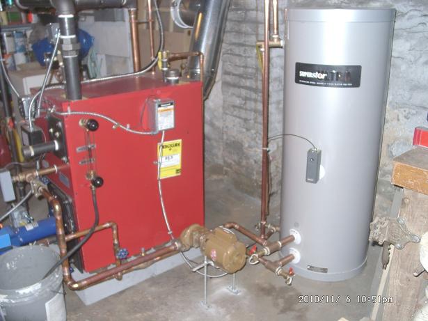

Q: Could I pipe an indirect domestic water heater off a steam boiler using the same piping techniques I would with a heating zone?
A: Yes. Just treat the indirect heater as you would a radiator. Make sure you blend return water into the hot boiler water to limit the supply to the heater to 180 degrees F Here's a sketch.

Q: Could I wire the boiler for priority. You know, either make steam or run the hot water zones, but not both at the same time?
A: Yes, but this limits the usefulness of the hot water zones. Suppose you want some heat but you can't get it because the steam zone is calling? Or vice versa.
