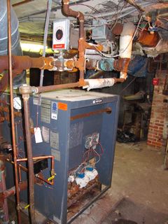

I heard from an old friend the other day. This guy works in Brooklyn, NY, and usually on some very interesting stuff. He's not one to say fuggedaboutit when there's a problem on a job. Here's what he wrote.
"Dan, I just finished installing a new Weil-McLain LGB-4 gas-fired boiler. This boiler is providing steam for a steam kettle in a commercial kitchen in a school. We installed main vents, a bucket trap for the main return line, and a Float & Thermostatic trap for the kettle. We also installed a condensate-receiving tank since we don't have enough height for the condensate to return to the boiler by gravity alone. We have a solenoid valve on the tank for feed water, as well as a tank overflow line to a drain, and a vent line so that the air can leave the kettle and vent from the tank.
"Today was the first time that we fired the boiler, and it went just as we had planned. After we cycled the boiler a few times, though, we shut down the system and watched as something very interesting happened. After the boiler started to cool down, water started to enter into the boiler, even though the feeder on the boiler was satisfied and the water was at the proper level. It just kept rising. And by the way, we have a spring-loaded check valve between the condensate pump and the boiler. I am sending you some pictures of the job."

My buddy had sent a lot of photos attached to his e-mail, and my phone was taking its sweet time downloading them because of me being in the penitentiary and all, so I just called him. Sometimes it's quicker to be old-fashioned, and besides, I didn't need the photos to know what was wrong with this one.
He told me how he and his helper watched the water fly up the boiler's gauge glass. "It was like it was being sucked right in," he said.
"It was," I said.
"What do you mean?"
"The boiler was sucking it in," I said. "Well, actually, the atmosphere was pushing it in, but you get the picture. There was a vacuum inside the boiler. It happens a lot with this sort of installation."
We talked about it and I got him thinking like steam, which always makes this stuff easier to understand. You just have to pretend you're the steam and then think about what you would do inside that system.
For instance, you begin as water in the boiler. The fire comes on and you get hot. When the flame adds enough sensible and latent heat to you, you decide it's time to change state from a liquid to a gas, and at that point, you go off like microwave popcorn. In fact, you go off even better than popcorn. You expand 1,700 times, shoving all the air that's around you toward the steam kettle. The air passes through the kettle, enters the kettle's steam trap, sails right through that trap and leaves the system through the vent on the condensate receiver.
As steam, you're now in the kettle. You can't get out of the kettle because of that steam trap (steam traps trap steam). So you give up your latent heat to the soup in the big kettle, which causes it to boil, and then you start shrinking back into liquid water. And as you do this, it would be wonderful if the air could work its way back into the kettle to fill the empty space you're leaving behind as you condense, but that steam trap is still closed. So what gets left behind in the kettle, and in the boiler (all the way back to the boiler waterline) is a vacuum.
With me so far? Good. Now think of the waterline in the boiler. It has a pressure above it that's lower than the pressure of the atmosphere. The water in the condensate receiver, which vents to the atmosphere, has atmospheric pressure sitting on top of it. In Brooklyn, this happens to be 14.7 pounds per square inch.
Okay, we have two containers of water (the boiler and the condensate receiver), and they're connected with a pipe. One container is under a pressure that's higher than the pressure that sits atop the other container. Separating these two containers of water is that pipe, and in that pipe there's a spring-loaded check valve. This is facing in the direction of the container that contains the low pressure.
Have you ever put air in your car's tires? High pressure goes to low pressure, right? You bet it does. Always. So the water inside the condensate receiver is going to flow into the boiler and flood it. From the outside, it looks like something is wrong with the automatic water feeder, but that device is innocent, so don't curse it and don't replace it; it's not at fault.
"You need to add a vacuum breaker to the boiler," I told my friend. "Put it anywhere above the boiler waterline and you'll be fine."
"Simple as that?" he said.
"Yep, and then you can fuggedaboutit," I said.
