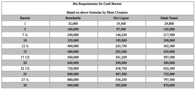

Based on his extensive engineering background, Mr. Clouston has some shortcuts which he feels are more accurate for sizing:
Brewkettle Heating and Boiling = 32,000 Btu/Hr/bbl
Hot Liquor Heating from 60-175F in 4 hours = 19,500 Btu/Hr/bbl
Mash Vessel Heating = 29,000 Btu/Hr/bbl

For ease of calculation, let us look at the heating requirements for a 10 barrel brewery with simultaneous operation.
Brewkettle 32,000 Btuh X 10 barrels = 320,000 Btuh
Hot Liquor 19,500 Btuh X 10 barrels = 195,000 Btuh
Mash Heating 29,000 Btuh X 10 Barrels= 290,000 Btuh
 SUBTOTAL = 805,000 Btuh
Cold piping loss 25% =  201,250 Btuh
Boiler Net Output =  1,006,250 Btuh
Boiler input @ 80% Boiler Efficiency = 1,257,813 Btuh
Boiler input @ 82% Boiler Efficiency = 1,227,134 Btuh
We would need a boiler with an input of about 1.2 Mil
