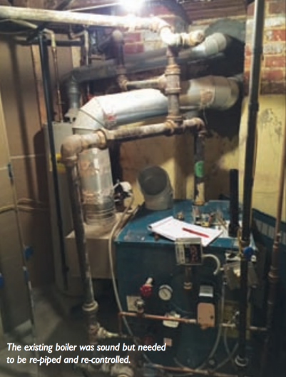

A Burnham Independence Atmospheric Draft Steam Boiler was installed about five years ago, but the near boiler piping was not to manufacturer specifications (see photo). The header was undersized and the counter-flow mains were not dripped. All of the start-up condensate flowed back into the header. A few minutes after steaming, the system would hammer horrendously and the furthest radiators would not heat at all. In an attempt to “force” the steam to these radiators, the pressure setting was raised to 4 psi. This just made the situation worse, as the condensate could not drain against the higher pressure in the undersized mains.
In addition, there were no main vents in the entire system. All of the air vented out of the radiator vents; very slowly. This caused the boiler to cycle on pressure and the radiators to heat unevenly. The closest radiators were hotter than a firecracker, while the furthest radiators remained stone cold. Because of the age of the house and settling, two of the runouts to the radiators were actually pitched the wrong direction causing condensate to puddle and hammer.
After surveying the system and sketching out a piping diagram, the primary deficiency was clear. There were only two 1-½-inch mains serving the entire system. Also, when the basement was finished, the pitch of both mains was changed to allow for more ceiling height. Condensate was backing up in the undersized mains creating severe water hammer and choking off the flow of steam to the radiators.
There was no fixing this system. The only solution was to cut everything out and start over. The radiators and some of the valves were able to be re-used. The boiler was very dirty and required a complete re-pipe, but was otherwise in sound condition. We did replace the relief valve, pressure-trol, LWCO and all operational controls including the gas valve, as it had operated for five years in under rough-duty conditions.

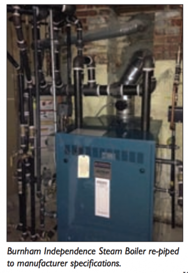

Next, Brian re-piped the near boiler piping to Burnham specifications (see photo). He piped two risers out of the boiler block to a drop header. He increased the header size from 2 inches to 3 inches. Both of these steps have the effect of drying out the steam, separating the condensate from the steam. He also increased the equalizer from 1-¼-inch to 1-½-inch to help stabilize the water line. A skim tapping was added to properly skim the boiler water line to remove dirt and oil.
The next step was to sketch out a piping diagram. Brian used a combination of “The Heating Helper,” published by Burnham, and “The Lost Art of Steam Heating,” by Dan Holohan. These two books contain all of the tables and charts required to properly size the mains, risers and radiator supply runouts.
Brian ended up with three new mains serving the system, two 2-inch and one 1-¼-inch. The undersized risers were re-piped with the proper size schedule 40 black steel pipe. The mains were pitched properly and securely mounted with new pipe hangers.

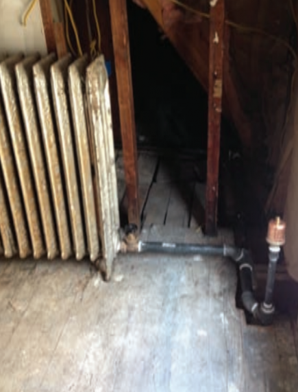

There was one riser than ran the furthest distance from the boiler that would not heat previously. Brian used an old trick and vented the top of the riser with a main vent (see photo). When the system was started, this riser now heated as quickly as the other risers and the previously cold radiators on this tier were toasty warm.
venting top of riser with main vent
One very important detail. When Brian piped the three properly pitched mains back into the boiler room, he dripped them before connecting them to the header. These drips connect to the wet return below the boiler water line. The purpose of these drips is to allow start-up condensate to drain back into the wet return rather than into the header where it will condense the steam and hammer.
One other detail that Brian changed was to connect all three mains directly to the header rather than to tee off of a riser as previously piped. This allows the steam to flow evenly and equally through each main without the turbulence created by a bull-headed tee.
