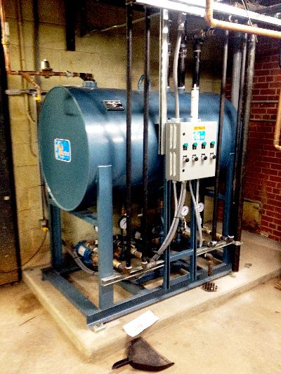

Makeup water is considered a steam boiler's worst enemy. Fresh water can take a system designed to last several decades and cut the life expectancy to only a few years. It is a good idea to limit the steam lost and the amount of makeup water introduced to your system. Since steam systems are open to atmosphere, there will always be a certain percentage of steam lost through evaporation or flash steam. Flash steam is the steam you see coming from the vent on the condensate or boiler feed tank. Do NOT ever plug or reduce the vent! It turns the tank into a bomb. Just thought I should mention that.
steam heating system
How much steam is normal? It should be an occasional wisp or small cloud. If you see a full pipe of steam chugging from the vent pipe, that is too much. You want to find the cause of the steam leak. That is your money wasted and the life of your system spinning down. There will always be a certain percentage of lost steam or water from a steam system. It is usually between 2-4% depending on the steam pressure; the higher the pressure, the greater the loss.

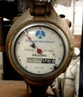

meter
One idea I like to see on a steam system is a water meter on the makeup water pipe. This will allow you to see if the system is losing water. I urge you to monitor water usage on a weekly or monthly basis to detect a leak. If you notice the use starting to trend up, you can be pretty sure the system is leaking somewhere.
