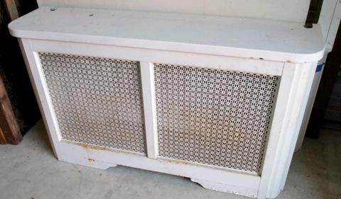

The radiator covers that the New Jersey Chief Justice talks about are the metal ones that have solid tops and a front that’s perforated with hundreds of holes across its entire surface. Putting one of those over a cast-iron radiator will cut the radiator’s output by about 30% because it inhibits air convection across the hot cast iron. It also keeps the kids from getting burned.
