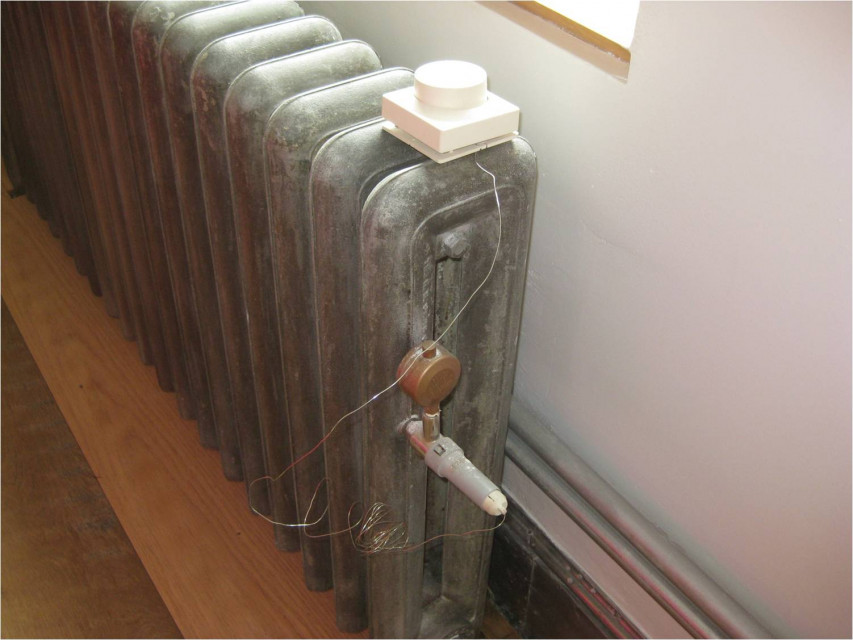

What's wrong with this picture?
See the remote thermostat sitting on top of the hot radiator? The folks in that office wondered why they couldn't seem to get comfortable.
You can't make this stuff up.

TRVs, when cared for, last a long time. They’re so simple in design. The bellows sometimes comes with a slender remote sensor that sits out in the air and feels the temperature. We use these when the radiator is inside a cabinet. A built-in sensor isn’t as good for this application because it feels the heat inside the cabinet and closes the TRV before the room can get up to the set temperature. This causes most contractors to curse the TRV manufacturer.
But now consider the installer, who many not be a contractor. The installer may be a handymen or the building superintendent. This person may decide to mount that crucial, room-air-temperature sensor, right on top of the radiator’s element. How come? To protect the sensor, of course. I have memories of some delicious, building-wide, no-heat situations caused by this. Wish you were there.
I’ve also seen handymen and building superintendents jam the TRV sensors between the fins of the heating elements. That’s to hold them in place. Hey, that sensor’s liable to slip off it you just put it on top of the element. You have to be creative. Ever see a TRV remote sensor attached to a radiator element with Krazy Glue?
Superintendents will also jam a TRV's sensor under a rug or a flap of linoleum. Again, this is to keep the sensor safe - and clean. Some have mounted the sensors on the radiator's supply pipe. That keeps them stable. They will also place the sensors precisely along that uncaulked crack between the floor and the wall. The low-bid building contractor left that crack as his legacy. This crack is the place where, in many older buildings, Mr. Breezy slips in whenever the exhaust fans starts. No heat? Hmmm.
