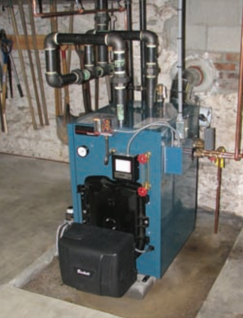

1. Pipe steam boilers with black steel
Steam boilers require schedule 40 black steel piping. I cringe when I see boilers piped in copper. It does not matter if you use L copper and 15 percent silver brazing rod. The copper expands much more than threaded steel, the joints cannot handle the torsional stress and they leak. That’s why you always see rags wrapped around the leaking joints or buckets underneath. The threaded joints can handle the stress much better. Copper does not belong on a steam boiler. I recommend taking this shortcut or you will be back fixing leaks.

6. Low water cutoffs
We install dual low water cutoffs on all of our steam boilers. It is cheap insurance. I have seen the results of a dry fired boiler. It is not pretty and it is extremely dangerous. We once had a combination low water cutoff/water feeder fail to function properly causing a commercial boiler to dry fire. When my technician arrived, the sections were glowing cherry red and the plastic trim and plastic gauge covers had melted. This was about as scared as I have ever been on a job site. We got lucky that time but I no longer leave it to chance. Two low water cutoffs go on all of our steam boilers and all safety controls are texted and documented before we leave the site.
7. Clean the new boiler
Whenever a new steam boiler is installed it must be properly cleaned and skimmed. The boiler sections contain oils from the manufacturing process and machining. New piping contains cutting oil. Dirt and sediment from the system work their way back to the boiler. All of these contaminants interfere with dry steam releasing from the surface. The oils and dirt need to be cleaned from the system and unfortunately there is no shortcut. We figure the better part of a day to do this and build it into our quote. Again, if you do not factor this into your bid, you will be back doing it for free.
I like to install a ball valve into the return line and waste the returning condensate rather than let it return back to the boiler. I will gradually fill the boiler manually to maintain a normal water line. Once the returning condensate runs clear, I will skim the boiler using a full size tapping. I will install a ball valve in the skim line to make this easier and plug it when we are done to prevent it from being opened accidentally.
We use chemicals sparingly. They are not a substitute for proper cleaning. A little bit of Rhomar steam cleaner usually does the trick but don’t go overboard or you will spend days getting the system to run clear.
