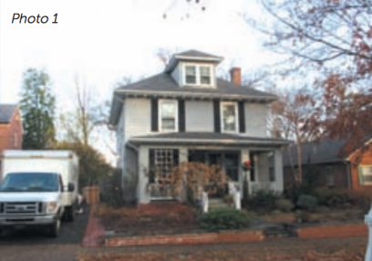

The next morning, I stopped by the customer’s house to survey the job. The house was an American Foursquare, circa 1915, located in Alexandria, Va. (see photo 1). It was heated by an old Hutchison Vapor System, a type of system I run across often in the Washington, D.C. area. This system was manufactured by the Hutchison Vapor Heating Corporation based in Washington, D.C. and has been gone for more than 80 years. I first ran across this type of steam system almost 15 years ago. Not knowing what it was, I contacted my friend and mentor Dan Holohan, who sent me all the information he had on the system.

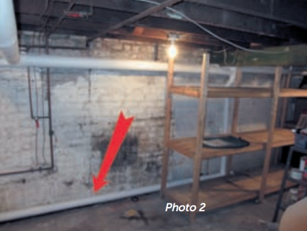

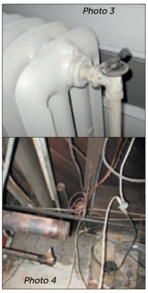

This was a two-pipe steam system that was designed to operate at very low operating pressure, ounces of pressure rather than pounds. There were no traps on the radiator outlets (see photo 2). Steam was kept out of the dry returns by a combination of graduated inlet valves (see photo 3) that would only allow a metered amount of steam into the radiators. The oversized radiators would condense the steam before it reached the outlet at a very low operating pressure of approximately six ounces. There was no main vent. The air was vented into the chimney, aided by the draft of the chimney. The remnant of this vent pipe is still visible (see photo 4). A boiler return trap originally returned water to the boiler when pressure got too high. This boiler return trap was no longer there, perhaps removed by the previous installer not knowing the importance of this device.

I noted that some of the graduated inlet valves were stuck and a couple had been replaced with hot water radiator valves. Again, while this was a contributing factor, it was not the primary cause. I traced the steam main around the basement, which was easier said than done. The client, to put it nicely, had accumulated enough stuff in his basement over the years to qualify for an episode of “Hoarders.”
After moving some boxes while searching for the end of the steam main, I located the problem. The steam main was dripped into a wet return that was no longer wet. It ran around the perimeter of the basement approximately 36 inches above the floor. Originally, this house had a tall boiler with a water line well above the return line. The current boiler had a water line about 24 inches above the water line making this formerly wet return a dry return. A minimum of 28 inches of vertical is required to allow the condensate to return by gravity. We had about 10 inches on this job.
When this return was exposed to steam pressure, the returning condensate was slammed around the piping by steam that was not intended to be there, creating the water hammer. Once I had a handle on all of the problems with this system, I proposed a solution that my client graciously accepted.
We restored this old vapor system to its former glory by replacing the boiler with a new properly sized Burnham Independence steam boiler. When sizing the boiler, I measured the connected radiation and piping taking into account the existing radiators were about 20 percent oversized to condense the steam. We re-piped the header to manufacturer specifications using both boiler outlets and a drop header to ensure dry steam at the lowest possible velocity. We then re-piped the returns and dropped them down to the floor making them wet returns (see photo 2). This solved the water hammer problem.
The graduated inlet valves were beyond repair so we replaced them with forged brass steam radiator valves and added steam traps at the outlets to prevent steam from getting into the dry returns (see photos 5 and 6). Since we installed a Vapor-Stat on the boiler limiting maximum pressure to 16 ounces, the steam traps were not absolutely necessary but I thought it prudent to avoid any future problems. These traps will keep steam out of the wet returns regardless of the boiler operating pressure.
