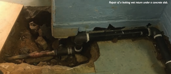

If only I would follow my own advice. This fall, we replaced a commercial steam boiler in a church in the Cleveland Park neighborhood of Washington, D.C. This work was done in late October, just as the weather started turning cold. We installed an eight-section boiler with a power gas burner. There were two dry returns and one wet return in the system. The wet return ran under a concrete slab. The nursery and child care facility for the church were in the basement. It would have been very disruptive to replace this wet return. I decided to tie this back in to the new boiler and hope for the best. Hope is rarely a good strategy when it comes to buried wet returns.
I received a call from the church in February. Water was bubbling up through the concrete floor. I did not need to go to the job site to know what it was. I sent my lead service tech there to identify the cause. Sure enough, the wet return was leaking. It is no fun busting up concrete to find the leak, cut out the bad pipe, and re-fit with new pipe (See photo).
leaking wet return
In this case, we used a combination of Pro-Press and threaded black steel pipe to make the repair (See photo). The work is noisy, disruptive and laborious. Busting up concrete with a rotary hammer is never any fun. Looking back, I should have recommended this work be done with the boiler change-out. It is easy to be the general after the battle is over. Lesson learned. Again.

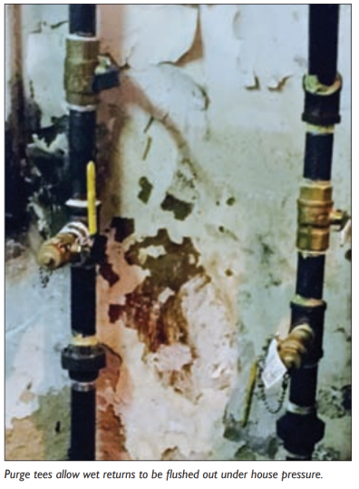

Sometimes the pipe is sound but full of crud and sediment. If that is the case, we will cut in a flush port (See photo). This allows us to isolate the wet return from the dry return, hook up a water hose, and flush it out under house pressure. Be careful, because if the pipe is not sound it could fail under house pressure, and you will definitely be replacing the piping. If the pipe is sound, when you flush it out, you will be amazed at the amount of crap that comes out the other end. You will wonder how the condensate ever made it back to the boiler.

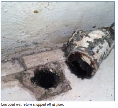

We use this solution sparingly, as it is always better to replace the wet return rather than flush it out. Again, we learned this lesson the hard way on a recent project. We were installing a Peerless commercial atmospheric draft steam boiler on a 1920s vintage two-pipe Dunham Vapor System. The dry return dipped into the slab for about three feet to traverse a hallway and drop into the boiler room.
In this case, I made the decision to cut in a flush tee and flush out the three feet of buried pipe. What are the chances that the only buried pipe in the entire system, and only three feet of it, was bad? The answer: 100 percent.
When my installation technician put a Sawzall to the pipe to cut in a tee, the return pipe snapped off at the floor. The only thing holding the pipe together was rust and paint. Now, we get to bust up tile and concrete. This client was not as understanding as the previous job, and we are doing the repair for free. Some lessons are learned the hard way.
