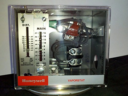

vaporstat

"But I've been here for seventeen years," the building engineer shot back. "And that's exactly what we've been doing. We've never raised the pressure above twelve ounces. We run the boiler on a vaporstat. Didn't I show you the vaporstat when we were in the boiler room?"

I think about this whenever someone tells me they raised the pressuretrol setting because they wanted the steam to get to the radiators faster. I always tell them to go back and crank it down. "That doesn't make sense," they'll say. But it's true.
I've learned that high-pressure steam can lock some or all of the air vents closed. And when that happens, you'll never get your radiators hot.
This is where the pressuretrol comes in. The pressuretrol operates the steam system on a curve. Cut-in, cut-out, cut-in, cut-out. It does this so the air vents can open and close. If you keep the cut-in pressure too high, some or all of the air vents won't open after the first cycle. Lower the pressure on that space-heating system and watch how much better it heats.
I've also learned that when the pressure is too high, people open the windows. They do this because they can. It's the only control they have. It's their double-hung zone valve. Want to cut the fuel bills? Crank it down!
