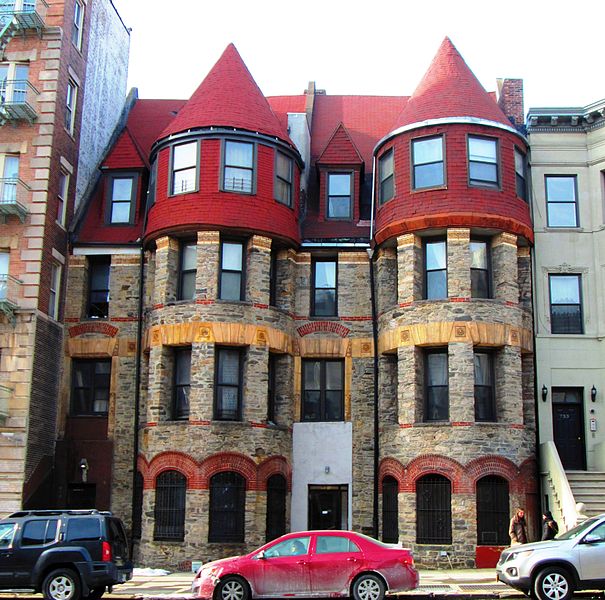

House of Theodore Minot Clark
Not many people graduate from Harvard at the age of 20 but Theodore Minot (who, understandably, went by T.M.) Clark did. Mr. Clark was born in Boston in 1845, the same year that The New York Herald first mentioned a new game called baseball. He went on to be the editor of American Architect magazine and he also was in charge of the Department of Architecture at M.I.T. for a good long time. He wrote several books and served as a director of the Workingman’s Building Association, which helped poor people buy homes so they could have a stake in America. Today, the Workingman’s Building Association is called the Boston Foundation. Nice.
