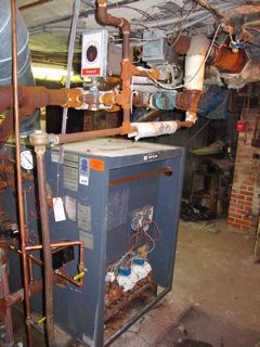

motorized valve on steam boiler

But now, someone shows up and adds their motorized zone valves to piping that's leaving the steam boiler. They figure that this will be a neat way to save fuel dollars. They're wrong, but you've met people who are wrong before, haven't you? Some of them can be very convincing!
Anyway, these valves will work beautifully - as long as they never close. As soon as one or more does close, however, that "leftover" steam pressure that you were depending on to put the condensate back into the boiler disappears. Now, all you have going for you is gravity, and that’s not enough to put the returning condensate back into the boiler. So the condensate backs up into the main and lies there, waiting for that evil motorized valve to reopen.
And when Mr. Valve does reopen, Mr. Steam comes raging through, meeting Mr. Condensate and sending him rocketing toward the end of the main where he lands with enough force to knock the building off its foundation.

You should never get yourself into these situations with gravity-return steam systems and motorized zone valves in the first place. But if you do, know that a half-inch line, run from one side of the zone valve (across the TOP, not the bottom of the valve) will bleed some steam pressure into the mains. It just might get you off the hook.
