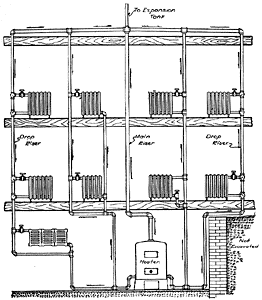

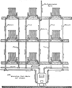

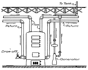

Q: What did a typical gravity hot-water system look like?
A: Here's a diagram of an "upfeed" system.
heating p8 245x300
Q: Why did they call it upfeed?
A: Because the water fed up from the bottom (the boiler) to the top (the highest radiator).

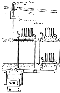

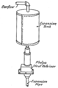

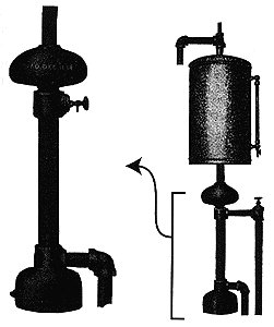

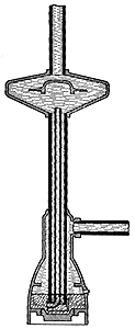

Q: What does an expansion tank look like?
A: A typical one looked like this.
heating p10 300x299

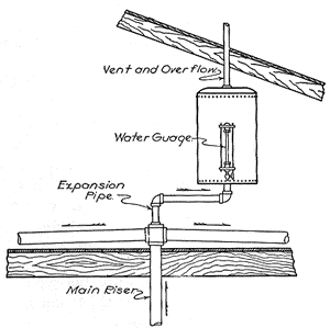

Q: Where did the expansion tank go?
A: Typically, at the high point of the system. You'll usually find them in the attic. The tank gives the expanding and contracting water a place to rise and fall.
Q: Suppose I put too much water into the system when I first fill it up. What will happen?
A: It will overflow from the tank through its vent and wind up on the roof.

A: Normally, you should maintain the tank at one-third full when the water is cold (there's often a gauge glass on the side of the tank so you can see what you're doing). As the water heats and expands, it will rise into the upper two-thirds of the tank and stop before spilling over onto the roof.
Q: How did they fill these tanks?
A: Some tanks had an automatic fill valve, which is very similar to the ballcock in a toilet tank. Others, the old-timers filled by hand with a valve that was either down in the basement or up in the attic.
Q: Wait a minute, if you're in the basement, how can you tell how much water is in the attic tank?
A: Good question! Chances are the boiler had an "altitude" gauge that showed the height of the water in the system. The gauge registered feet of altitude as well as static pressure.

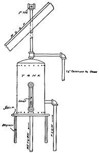

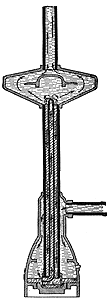

Q: Is there a danger of the attic tank freezing if the attic isn't properly insulated.
A: Yes, there is. And if that happens, the expanding system water will have nowhere to go. To avoid this potentially dangerous situation, many old-timers piped their tanks like this.
heating p13 194x300
That second pipe, connected into the side of the tank, allows hot system water to circulate through the tank. Since the water is hot and in motion, it's much less likely to freeze.

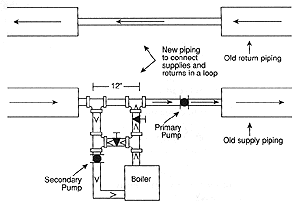

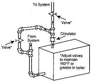

Q: Suppose I decide to modernize the system by adding a circulator or replacing the boiler. Should I keep the open tank?
A: In a case such as this you'll probably want to close the system by replacing the open, attic expansion tank with a closed compression tank. This isn't always necessary, but it does cut down on the corrosion that takes place in the system.

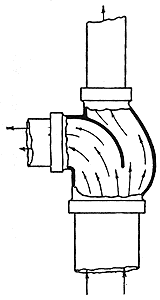

Q: How did they pipe the radiators into the mains on this system?
A: They always used top and bottom connections. They could enter the top on one side of the radiator and leave through the bottom on the opposite side, or they could enter and leave through the same side. This second method saved a riser which made for a less-expensive installation.

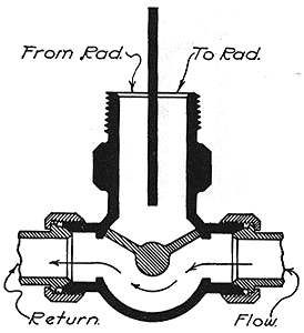

Q: Didn't they need special fittings to make this work?
A: Yes. They had to divert water through the radiator. To do this, they used a special type of tee. Here's a picture of one.
heating p15 160x300

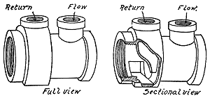

Q: What did they call this tee?
A: They called it an "O-S" fitting after its inventor, Oliver Schlemmer of Cincinnati, Ohio. It was a beautifully simple device.
Q: Is this similar to a "Monoflo" tee?
A: It is, but the O-S preceded the Monoflo by many years. During the 1930s, the Bell & Gossett Company introduced their "Monoflo" tee (the name is a trademark). It went on to play a big part in American house heating during the years before World War II.
Q: Do these special tees "tell" the water where to go?
A: In a sense, they do. They create a path of least resistance for the water and direct it toward the radiator.

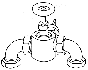

Q: Is there any other way of directing the water in this type of system?
A: There are a number of ways, and all of them are critical to the system's operation.
Q: Why is this?
A: Because the pipes in a gravity system are very large and contain a lot of cold water on start-up. Not all of that water is going to get hot at the same time. And since hot water is lighter than cold water, it has a tendency to shoot directly up to the top-floor radiators - just like a hot-air balloon. That's its path of least resistance.
Q: So the top floors tend to heat more quickly than the bottom floors in a gravity system?
A: Yes, and that leads to system imbalance.
Q: How did the old-timers get around this problem?

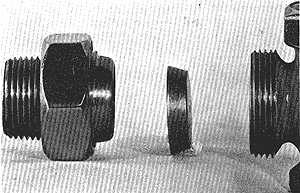

A: They sometimes added orifice plates to the top-floor radiator hand valves. Here's what one looks like.
 heating p16 300 193
Q: What exactly is an orifice plate?
A: It's a round piece of metal with a small hole drilled through its center. You could make one yourself out of sheet metal; most of the old-timers made their own.
Q: How did the orifice plate direct the water?
A: By increasing the resistance through the radiator it was assigned to. If water found it difficult to enter, say, a top-floor radiator because of the orifice plate, it would go to a radiator on a lower floor instead. In this sense, the orifice plate was similar to the "O-S" and "Monoflo" fitting. The big difference, however, was that instead of directing the water into the radiator it was assigned to, an orifice plate directed the water away from that radiator.
Q: What other methods did the old-timers use to make the water go where it was supposed to go?

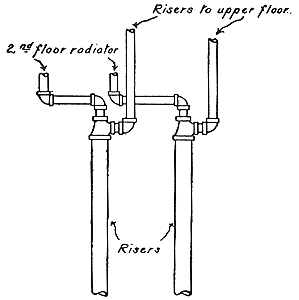

Q: So you can tell from the basement where the risers are going?
A: Yes! They usually fed upper-floor radiators from the side of the main and first floor radiators from the top. That way, the system went into more of a natural balance.
Q: Did they do similar things with their vertical risers?
A: Yes, they did. Frequently, they'd supply a second-floor radiator from the top of the riser and a third-floor radiator from the side of that same riser.
 heating p18 299x300
In this case, the second-floor radiator is the lower of the two. That's why it gets the water from the top of the riser.

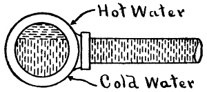

Q: How about the supply and return mains. Do they have to be kept close together?
A: Yes, Ideally, the return main should parallel the supply main within a distance of no more than 8-1/2 inches. It should drop only when it reaches the boiler room.

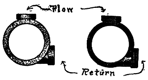

Q: Were there any special fittings for the mains?

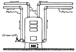

A: They used a number of them. Here are two examples of the more common ones. This is called a Eureka Fitting.
heating p20 300x141
This one was known as the Phelps Single Main Tee.
 heating p20 300x163
Notice how the hot water leaves from the top of the fitting while the cold water flows back into the side. Those old-timers were clever, weren't they?

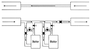

Q: Is it difficult to troubleshoot gravity hot-water systems?
A: Troubleshooting can be tricky. There may be places in the system where hot and cold water pass each other in the same pipe. That might be perfectly normal, but you'll need to "see" it in your imagination to figure out what's going on.
Some problems may have existed for years before you got involved. Something as simple as an unreamed pipe can stop a radiator from heating, but then, so can the corrosion that builds up after sixty or seventy years of operation. You'll have to think clearly, and ask lots of questions.
Q: Does the water flow the same way here as it does in a forced circulation system?
A: Not at all! In fact, gravity hot-water heat is the mirror image of forced hot-water heat. When you use a circulator in any system, the path of least resistance will always be the shortest (lowest pressure drop) loop because that's the path with the least resistance to flow. Water is lazy, and when you pump it, it always wants to get back to the pump's suction as quickly as possible. Remember, in a gravity hot-water system, the path of least resistance is the top floor, which is usually the longest run. That's the opposite, the mirror image, of a pumped system.

A: The old boiler probably has two outlets and two inlets because the idea in those days was to get the greatest possible gravity-induced flow of water through the boiler. The more holes, the better the circulation. That piping looked like this.
heating p23 300x205
When you add the new circulator, you won't need to use such big pipes coming and going out of the boiler. In fact, you'll want to reduce the size of your near-boiler piping to give the circulator something to "push" against.

Q: Do I have to use a bypass around the boiler on these jobs?
A: Most boiler manufacturers recommend that you install a bypass around their new boilers when you use them on a gravity system. Here's what that bypass piping looks like.
heating p26 300x268
Q: What's the reason for the bypass?
A: It's there to protect the boiler against condensation and thermal shock.
Q: What's thermal shock?
A: Thermal shock is what happens to hot metal when you hit it with relatively cold return water. If you take a glass plate out of the oven and run cold water over it, it will break, won't it? That's thermal shock.
Q: How does the bypass piping help prevent this?
A: The bypass allows hot boiler water to enter the returning colder water and raise its temperature. The combined flow then enters the boiler at a temperature greater than 140-degrees F., which is the minimum allowed for many boilers.

Q: How do I pipe for primary/secondary flow?
A: Tie the existing supply and return lines together to form a system loop. Then, use two standard tees, set no further than a foot apart, and attach the new boiler to the loop. Like this.
heating p28 300x206
The primary pump serves the system, while the secondary pump takes care of the boiler. You meet the flow needs of both in a very simple way. The not-more-than-twelve-inch spacing between the tees allows the pumps to operate independently. When the secondary pump is off, there will be no flow through the boiler if you keep the spacing within that 12" limit.

Q: Can I use more than one boiler with this type of system?
A: You sure can! This system is ideally suited to a multiple-boiler set-up. Watch.
heating p29 300x165
Here, we're using two boilers instead of one. The primary pump moves the water through the radiators. The secondary (boiler) pumps come on to bring a portion of the primary flow through the boilers. On mild days, you'll use just one boiler, on colder days, the boilers will piggy-back to bring the water temperature up to the right level.
Q: What's the advantage of using two boilers?
A: Each boiler is sized to half of the maximum load. For instance, let's say the total required load on the coldest day of the year is 250,000 Btu/hr. If we use two 125,000 Btu/hr boilers instead of one 250,000 Btu/hr boiler, we'll be burning about half as much fuel during a large part of the heating season.

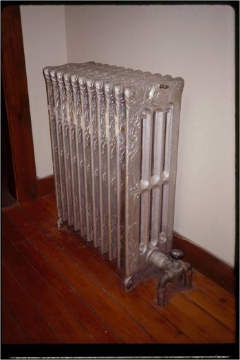

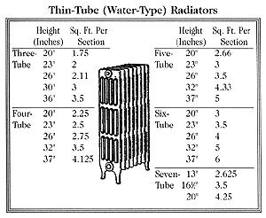

Q: How will I know how many square feet of radiation each radiator contains?
A: You can use this chart as a guide:
heating p31 300x246
Q: What is a Square Foot of Equivalent Direct Radiation equal to in Btu/hr?
A: For gravity conversions, we can say that each square foot of EDR will be equal to 150 Btu/hr when the average water temperature is 170 degrees F

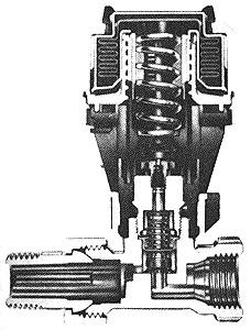

heating p35 228x300
These devices sense the air temperature in each room and modulate the flow of water through the radiator. They're completely self-contained and need no electrical wiring. They last for years, are relatively inexpensive and have been around since the 1920s. I've found they keep the room temperature within one or two degrees F of the set point. With thermostatic radiator valves, every room becomes its own zone.
Should you chose to use them, set the circulator to run continuously during the cold months. The valves will take care of the comfort level in each room. If you want to take control a step further, vary the boiler temperature based on that outdoor-air reset controller I mentioned before. This control also helps do away with any expansion/contraction noises you may have in the system.

A: Yes, Honeywell made a system called "accelerated hot water heating" which was very popular in its day.
Q: When did they use this system?
A: In the early days of this century.
Q: Are these systems still around?
A: There are enough of them out there to make you scratch your head in wonder.

A: As much as 10 psig at the top floor, and since the boiling point of water increases with a rise in pressure, they could have temperatures as hot as 240 degrees F in the radiators. That made the water circulate very quickly.
Q: Was there a danger in pressuring this type of system?
A: Normally, there would be because the expansion tank was the weak link. It was usually made of copper or galvanized steel and held together with rivets. It wasn't built to withstand to take the strain. Apply too much pressure and the tank could (and frequently did!) explode, taking the top of the house with it.
However, with the Honeywell system, a special device called a Heat Generator kept the tank separated from the boiler, the system piping and the radiation.
Q: What did this device look like?
A: It was made of cast-iron and stood about 2-1/2 feet high.
heating p37 123 300
There was a narrow steel tube inside the unit's main tube that dipped down into a pot filled with mercury.
Q: Why did they use mercury?
A: Because it's heavy. They used the mercury to separate the water in the boiler, piping and radiation from the water in the open expansion tank. Here, take a look at how the Heat Generator tied into the system.
The top pipe went up to the open tank. The side pipe connected the system to the Heat Generator. The mercury kept the two sides separated.
Q: How did the Heat Generator work?
A: As the old-timer built pressure on the system, the water in the boiler, piping and radiation expanded and pressed down on the mercury.
heating p38a 300x240
heating p38b 109x300
The mercury rose up the narrow tube and cascaded back down into the pot through the wider, outer tube. As long as the water was expanding, the mercury continued to circulate.
Q: Why didn't the mercury rise up into the open expansion tank?
A: Because of its weight. Mercury's pretty heavy. In fact, it's nearly fourteen times heavier than water.
Q: Can the water in the boiler, piping and radiation enter the bottom of the mercury tube?
A: Yes, if the system pressure rises high enough. The water will then enter the tube and separate from the mercury in that wide separation chamber at the top of the Heat Generator. From there, it rises into the expansion tank.
Q: So the Heat Generator wouldn't let the system pressure rise above a certain pressure?
A: Right! It limited the system pressure to 10 psig at the top, without putting any pressure at all on the open expansion tank. This made the operation thoroughly safe, and it also made the water circulate very rapidly.
Q: I can see how Honeywell's device increased the speed at which the system heated, but what advantage, if any, did it offer the installer?
A: Because of the higher temperatures, the installer could downsize all his radiation by as much as 15 percent.

A: There were a bunch of others. Here's another example. They called this one the Phelps Heat Retainer.
heating p40a 198x300
This device operated by opening and closing a double-acting valve which was encased inside a cast-iron box. The side of the valve which opened to the atmospheric tank had a 16-1/2 pound weight. This weight would lift and open the valve when the system reached 250 degrees F. The expanded water then moved safely into the open tank.
When the pressure dropped below 16-1/2 pounds the weight closed the valve and the shrinking water opened a retainer valve which allowed the water in the tank to reenter the system piping.
Q: Did Honeywell use a special valve at the radiators?
A: Yes, they had something called the "Unique" valve, and from the looks of it, I'm sure you can see why they called it unique!
heating p40b 300x240
Q: How did this valve work?
A: To understand, you have to look inside. Here's a picture of the valve when it was closed.
heating p40c 274x300
As you can see, water flowed past the radiator when the valve was in this position, but look what happens when you open the valve.
heating p41 239x257
The water now enters the radiator on one side of the internal baffle, as the cooler, return water moves in counter-flow past the other side of the baffle.
