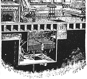

Q: How did they do this?
A: They placed the indirect radiators outside the room they were heating (that's where the name "indirect" comes from). They used ductwork to direct the fresh, outside air across these remote radiators where it would be warmed before rising into the rooms.
Q: Where exactly did they place these radiators?
A: Almost always in the basement, and usually right under the room they were heating, but they could also put them in a central location and feed the ductwork off to the rooms. It all depended on the size and shape of the house.

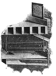

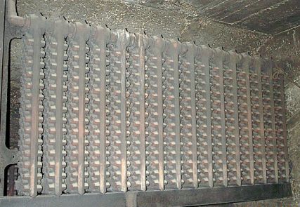

Q: What does an indirect radiator look like?
A: Most look like small cast-iron sectional boilers, without the jacket, of course.
indirect hot water heater
The old-timers used iron rods to suspend them from the basement ceiling inside the duct. Many are heavy enough to cause the floor above to sag. The first time you run across one can be a pretty intimidating experience.

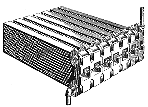

Q: Were all the radiators made from cast-iron?
A: No, some were steel, and these looked a lot like fin-tube radiation, minus the enclosure.
fin tube indirect heater
A typical steel, indirect radiator could have a dozen or more tubes set up side by side within the duct. Air flowed by gravity from the outside to the rooms.

Q: How can you tell the potential Btu output of a cast-iron indirect radiator?
A: First, you have to be able to see the radiator well enough to count and measure its sections. The duct will have an access door, but it's sometimes difficult to get a clear view of the radiator.
Q: Let's say I can get the measurements I need. Where do I find the ratings?
A: The American Radiator Company was once the largest manufacturer of indirect radiation. The unit you have is probably one of their "Vento," "Perfection Pin" or "Sanitary School Pin" models. Their 1925 book, The Ideal Fitter book, which you'll find in our Heating Museum, shows the ratings for these.

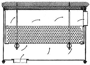

Q: Does it matter where the old-timer set the radiator inside the duct?
A: Yes, an indirect radiator should be a about 10 inches below the top, and at least eight inches above the bottom of the flue. It should also be tight against the sidewalls of the duct. Just like this.
indirect heater air circulation pattern
Q: Are these dimensions crucial?
A: They are if you want to get the proper flow of air across the radiator.
