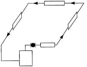

Q: What's loop hot water heating?
A: It's the simplest method of heating with hot water. Each zone consists of a single loop made up of the pipe and the radiators. The water flows out of one radiator into the next.

Q: Does this mean I have to use baseboard radiation if I want to install a loop system?
A: Not at all. You can make a loop system with just about any type of radiation. All you have to do is pass the water from one radiator to the next in a series.
Q: Is there a drawback to using other types of radiation in a loop system?
A: There can be a drawback to using any type of radiation in a loop system, and that includes baseboard radiators. Your success depends on how accurately you sized your radiators to the heat loss of the rooms they're going to serve. If you oversize the first radiators on the loop, the water may be too cool by the time it reaches the last radiators on the loop.

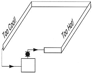

Q: What sort of problem would that give me?
A: The last radiators might not be able to heat the rooms they serve on the coldest days of the year. Your system would be out of balance.
Q: How likely am I to run into this imbalance problem?
A: It all depends on how the builder laid out the rooms and whether or not the people leave the interior doors open or closed. Most installers run baseboard from wall to wall. This looks neat, but it has nothing to do with how much heat the room needs on a given day. Too much or too little radiation leads to imbalance and discomfort.
Q: Can you give me an example of this?
A: Sure! Let's say you're putting a baseboard loop system into someone's house. The first room the loop enters is a bedroom which measures 15' X 15'. If you run baseboard around the perimeter, you'll be installing 30 feet of element. Since each linear foot of baseboard puts out about 600 Btu/hr (when the average water temperature is 180 degrees F), your radiator will be pumping about 18,000 Btu/hr into that bedroom. Suppose the heat loss of that room is only 8,000 Btu/hr on the coldest day of the year? You'll be overheating the room every time the system comes on.
Q: Won't the thermostat just turn the circulator off if the room gets too hot?
A: That depends on where the thermostat is. Suppose it's not in the bedroom. Suppose it's in the living room. Is there enough baseboard in the living room to shut off the thermostat before the bedroom overheats? Maybe someone opened the front door and there's a cool breeze hitting the thermostat. And keep in mind that since the loop goes to the bedroom before it goes to the living room, the water in the bedroom radiator will be hotter than it is in the living room radiator. That also contributes to the imbalance.
Q: So in a case such as this, would it be smarter to route the loop through the living room first?
A: It depends on whether or not the people living in the house like a cool bedroom. If they do, it would make sense to send the hottest water to the living room first, but remember, there are probably other bedrooms to consider as well on this loop.

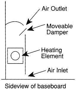

A: The best way is to size the radiation to the heat loss of the individual rooms. However, if you've already installed the baseboard you can cut down on the amount of heat coming out of each section by closing the dampers.
Q: How does that affect the amount of heat coming out of the radiator?
A: The damper slows the flow of air through the radiator.
baseboard element
Keep in mind this type of radiator works by convection. The air surrounding the radiator picks up the heat from the hot element and rises. Colder air enters the radiator from the bottom to take the place of the rising hot air. If you close the damper, you slow the movement of air and decrease the radiator's Btu/hr output.

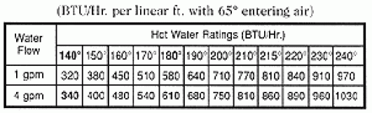

A: It sure would, and this is a good time to look at the way radiator manufacturers rate their units.
baseboard output ratings
Here are the ratings for a popular brand of 3/4" copper fin-tube baseboard. As you can see, when the average water temperature of a 4 gpm flow through the baseboard is 180 degrees F, each linear foot of baseboard will put out 610 Btu/hr. However, if you lower the average water temperature to 140 degrees F, each linear foot of baseboard will only put out 340 Btu/hr.

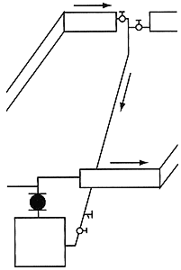

Q: Suppose I need to install 100 feet of 3/4" element on a single loop to give me about 61,000 Btu/hr. How can I do this?
A: The simplest way is to split the loop.
baseboard split loop
Leave the boiler and head in two directions, assigning part of the 100 foot total to one side and the balance to the other side. Join the two ends together with a single pipe and return to the boiler.

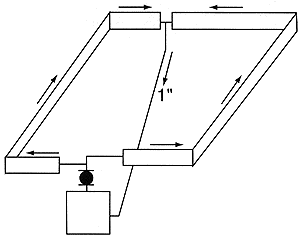

Q: Will that common pipe have to be larger than 3/4"?
A: Yes, in this case, it would be 1".
Q: How come?
A: Because it has to carry the combined flow of both sections of baseboard. If the common return pipe is too small, you won't get the flow you need through the baseboard.

A: The baseboard manufacturer. Let's take another look at that rating chart.
Notice how they list the heat output per linear foot at 1 gpm and 4 gpm. This has been a testing standard for many years. The 4 gpm flow rate is a maximum because if you make the water move faster than this you'll get velocity noise.

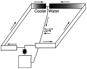

Q: Suppose I joined the two sections of the split with 3/4" pipe. What would happen then?
A: If the two sides of the split loop were in balance, you'd probably get about 2 gpm flowing through each side. The flow limitations through the common pipe sets up what happens in each side of the split loop.
Q: How will this affect my system?
A: You'll get less heat from the baseboard.

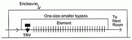

Q: Is there a way I can zone each room in a loop system?
A: Yes, you can do it with thermostatic radiator valves.
Q: What are they?
A: A thermostatic radiator valves, or TRV, is a self-contained, non-electric zone valve.
You may remember these from Chapter One. A TRV has two parts: a normally open, spring-loaded valve, and a temperature-sensitive valve operator. You pipe the valve into the line. The operator senses the room temperature and throttles the flow of water through the radiator. You can set the TRV to maintain any room temperature between 50 and 90 degrees F. The circulator operates continuously in when you use TRVs.
Q: If I use them on a loop system, won't the first TRV on line shut off the flow to the whole loop when it's satisfied?
A: Normally, it would, but when you use these valves on a loop system, you also use a bypass line around the element.
baseboard bypass for trv
The bypass line is smaller than the baseboard. When the TRV begins to throttle, the water passes over the element and moves on to the next room. In a strict sense, you don't have a one-pipe loop system once you add TRVs, but you do gain a lot of control and solve your heat balancing problems once and for all because TRVs also compensate for heat gain. If it's a sunny day, or if there are a lot of people in the room, the TRV senses the rise in the air temperature and throttles the flow of hot water through the element. TRVs put the home owner in control.
