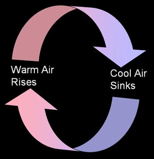

The recessed floor-convectors work by convection. These units heat the air above their elements and cause it to rise. The cooler air along the floor will then fall into the convector’s recessed trough and be heated. It, in turn, will rise and create a convective movement of air within the room. The movement of air will be very similar to the movement of water in the ancient gravity hot-water system that had served the old house for so many years. The principle was the same.
Now the kick-space heater also worked on convection, but it had a fan. It used that fan to draw in the air near the floor. It heated the air, and then it kicked it back into the room - right at floor level. The heated air rose toward the ceiling and tumbled the rest of the air in the room in a second convective current.
And it was then that the contractor and the engineer began to consider what happens to the recessed floor-convectors when the kick-space heater is shooting hot air across the floor? How can warm air rise out of the recessed convector if there’s no cooler air to replace it?
It occurred to the contractor and the engineer that these two types of heaters will never get along within the same zone. Each unit is looking for something different and the problem will always crop up on the coldest days of the year because that’s when both units are needed. Until they began to use their imaginations, the engineer and the contractor couldn’t see those air currents fighting each other. Once they opened their eyes, though, the solution was easy.
They drilled some holes in the bottom of the recessed convector. That allowed air to circulate up from the basement and the problem was solved.
