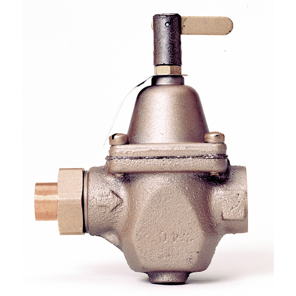

Now there’s a question for you. The feed valve’s job is to, well, feed. You figure out the height of the hydronic system from the point where the feed valve is to the highest hydronic component or pipe. You take that height in feet, divide it by 2.31 to convert it to pounds per square inch, and that tells you how much water pressure you need to fill the system to the top. And since you’ll need some pressure at the top so you can vent air from that point, you’ll add a couple of psi to what you just came up with. Simple, and something you probably already know. I mention it just in case you don’t.
But here’s the thing: Since hydronic systems are closed to the atmosphere (or at least they’re supposed to be), you shouldn’t need that feed valve again unless you drain water from the system, which may make you wonder why you bought the darn thing in the first place, right? I mean some of the feed-valve manufacturers tell you to shut the valve once you’re done filling the system. In fact, they do more than tell you; they plaster their installation-and-operation instructions with WARNINGS, which threaten you and your customer with portents of personal injury and/or death should the valve remain open. And let’s face it, that’s enough to make even Chuck Norris nervous.
But what if you close the feed valve and the air vents finally finish doing their job on those far-out circuits (such as those long, secondary radiant circuits that we love so much) and the system pressure drops a bit. Now you have to go back to fill the system by hand, and that costs money. And since you’ll be adding cold water to the system by doing this, and since cold water contains air, you’ll probably have to go back more than once. Oh, the misery of it all! What’s a contractor to do?
You don’t want to leave the fill valve open and defy the manufacturer’s instructions (and all that implies); but you also don’t want to have to keep going back to the job because that’s just going to eat up your profit, aggravate your customer, and make you look and feel like an idiot.

“If you have a rubber-tube radiant system, you either have a working fill valve or you may have to return every heating season to add a shot of fill water. For some reason, many of those systems tend to need a boost of pressure every year.
“I've tested some to 100-psi (tube only) for 24 hours and they held, but over the summer they drop enough to prevent boilers with low pressure switches from operating.
“I suspect that for every disaster story of a fill valve left on, you could find one for a fill valve left off. Vacation homes are a classic case of freeze-up due to low-pressure lockouts that could have been prevented if the fill valve was allowed to do what it was designed and intended to do.
“It’s your choice and there are plenty of arguments either way you go. It's a sad day when lawyers dictate hydronic installations. Which is the lesser of the two issues?
“Some auto-fill valves come with a knob to regulate flow. Once the system fills and purges you can adjust the flow to provide some make-up without flowing 4 GPM in the event of a break, and maybe that’s a compromise?
“A large radiant job can take days to purge all the microbubbles, I'd advise leaving the fill on for a few days or a week, or you may be returning every day to top it off, only to meet an unhappy, no-heat customer.
“Perspective varies depending on whether you’re manufacturing, selling, or on the receiving end of the unhappy customer calls. They just want the reliable heat and domestic hot water you promised and billed them for.
“Maybe the tank-fill systems with alarm contacts tied into a phone dialer would be another answer. But whose phone number should we use?”
