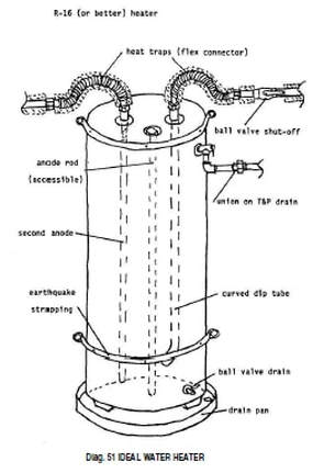

For many experienced plumbers, there really isn't much to replacing a water heater. It's an easy job: just pick up one that matches what's there, maybe strap it in, and leave with the old tank. Whoa. What's wrong with this picture? Just this--it portrays the minimum. Unless you're quite happy with the amount of work you have, the amount of money you make, and the amount of satisfaction your work provides, it's to your advantage to be able to deliver the maximum. When you get jobs because you offer substantial benefits rather than the lowest price, you'll gain long-term, trusting clients and business from their friends, as well.
Stand out from your competition. Hot water can change from bread and butter work to something you can actually be proud of. Many clients will gladly pay for superior work. It's true that people often call just shopping for price. (If you look in the Yellow Pages, you'll see most all the ads shouting, "We cost less!" Inadvertently, plumbers' ads have been training consumers to focus on price for years.) Never mind. Stop and talk to these callers. Tell them how YOU install a heater. Explain how the extra things you do will save them both money and worry because the heater will be safer, perform better, and last much longer than an ordinary installation. Let them know that you can provide simple, ongoing maintenance to at least double the life of their new heater. In most cases, you can keep their heater going for as long as they live there. (Some of our clients' heaters are more than fifty years old.) Many people will be very interested in what you have to say. Well, what do you need to know to provide this superior installation and follow-up maintenance? It's useful to start with an understanding of the things that make a water heater fail. Most people have only a partial picture of what goes on inside a water heater that affects its longevity. Corrosion, pressure, and heat are the three things that can do a heater in.

Even with the large earthquakes of the not-too-distant past and with the codes mandating specific strapping, we still see new heaters installed with inadequate bracing. Quakes WILL happen. We just don't know when. Be sure your heaters are correctly strapped.
Leak Protection
Probably not life-threatening, leaks can cause a whole lot of costly damage. So look around each job site to see what would be damaged if the water heater leaks. (And if it leaks for three weeks while the owners are in Tahiti?) If nothing will be hurt, you don't need a drain pan. Otherwise, you do. The pan also needs a drain line that's actually hooked up. (We've seen drain pan outlets just covered with duct tape, out of sight behind the heater.)
There are some interesting devices on the market now which are designed to shut off water supply to the heater if it starts leaking. Another option which might give your client peace of mind is a water alarm in the drain pan. To avoid false alarms or damage to the heater, run the drain line from the T&P out separately. Lines from both the T&P and drain pan should end where the homeowner will see them and be alerted to any leak.
Energy Efficiency
Recent energy difficulties have raised awareness in consumers and plumbers alike. The need for efficiency in hot water systems is better understood and accepted. Correct heater sizing is one of the most important factors in the energy picture, but it's often overlooked. If you're called to replace a heater, don't automatically put in the same size. Ask some questions. Did the old tank provide adequate hot water? Have new fixtures been put in (low-flow showers, aerators, front-loading washing machines)? Check older showerheads. If you find an old 8 gpm showerhead, you can probably reduce the heater size by installing a low-flow shower. The energy savings will quickly pay for it. Smaller heaters always have a higher energy factor, due to lower heat loss. Whatever the size, heaters with good insulation cost little more than their thinner counterparts. If you're installing a new heater and can get those extra inches of insulation to fit into place, your client will thank you for it. Tanks with R-16 insulation are readily available these days, and in popular sizes they can even cost less than the old standard R-8 heaters. Blankets aren't nearly as good as built-in insulation. Even the best blanket won't insulate your heater to R-16 (and you should not cover the top and lower portion of the heater). Another drawback is that blankets cover up safety and operating instructions; they can also hide evidence of leaks.
Go beyond the tank itself and install heat traps on the lines above the tank. Avoid the chattering ball type and install silent ones; you can make your own by using long flex connectors to make an upside-down U in the lines. Heat traps prevent errant BTU's from wandering away. In addition, insulate those plumbing lines. Insulate as much hot line as you can and the cold line back five feet from the heater, if possible. Use 3/4" thick foam; it takes no more effort than putting in thinner stuff, and it does a much better job. Leave the ends of flex-lines or other unions uncovered, as you may need access and you don't want hidden leaks.
The End Result
It's within your power to give your clients the most satisfactory water heating experience they've ever had. Long service life, safety, and efficiency are intertwined, and serviceability (the things you've built in which make the heater easy to maintain) overlaps all three areas. If you don't set up a heater so it's easy to service, maintenance probably won't happen. Forget trying to offer the cheapest heater. Instead, educate clients a little so they will let you give them an outstanding job. They'll be happy you took the time to show them a better way.
