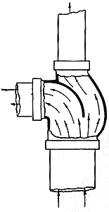

Mr. Schlemmer died six years after the fire, and 44 years before I was born, but I’ve known him for a long time. Two years before the fire, he cast a very special tee in that building by the ballpark. He named it the O-S fitting, after himself. For years, I had that tee on my desk and I would look at it and consider all that it meant to hydronic heating. A friend once showed interest in the tee, so I gave it to him. We never really own any of these artifacts. We only take care of them and share them.
The O-S fitting was the first tee capable of consciously diverting water into a radiator. It was wonderfully simple. It has one way in and two ways out. It also has a cuff cast into the inside to coax some of the water out the side rather than have all of it flow straight through. Mr. Schlemmer was a hot-water man and he was looking for ways to compete with the steamfitters. They had an advantage at the Turn of the Century because steam return pipes are smaller than steam supply pipes. A hot-water man had to work with larger pipes, and the return lines were as large as the supply lines. And there were no circulators. We don’t see those until Homer Thrush (in the U.S.) and Louis Opländer (in Germany) simultaneously invent them in 1928. Mr. Schlemmer had only gravity.

Mr. Schlemmer’s tee looks so ordinary from the outside. But the water is on the inside and when it crashes into that internal cuff, some of it is going to flow out the side of the tee and into the radiator. This gave him a way of piping hot-water with one pipe instead of two. It let him compete with one-pipe steam, which was cheaper to install than a two-pipe, gravity-hot-water system. Oliver Schlemmer invented one-pipe hydronic heating.
Later, Bell & Gossett’s Monoflo® Tee and Taco’s Venturi Fitting followed, but both owe a debt to the O-S fitting. And all obey The Law of the Tee. Whatever goes into a tee must come out, and if you plan well, the water will go where you want it to go.
