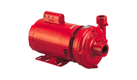

And consider a two-horsepower, Bell & Gossett Series 1535. That’s the little close-coupled, end-suction, base-mounted pump you see on so many cooling towers all across America. It's the one in the picture at the top of this story. Run that pump with the valves closed and you’ll get a temperature rise of 1,590°F per hour.
