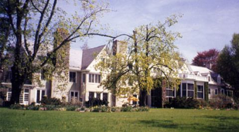

Not long after The Lovely Marianne and I started this little business of ours in 1989, a caretaker called and asked if I would be willing to consult on a problem hot-water-heating system in “the biggest house you will ever see.”
Who could say no to that?
The house, I soon learned, was the mansion at Duke Farms in Hillsborough, New Jersey, and the only resident of that house was Miss Doris Duke, only child of James Buchannan Duke, and heir to the American Tobacco Company fortune, as well as some other opulent things. And as large as it is, the house shrinks into place on the 2,700 acres of manicured gardens that surround it. How’s that for a lawn?
This is the family that endowed Duke University, which also has a very nice lawn. J.B. Duke knew how to put up significant buildings, designed to laugh at bad weather and hard times, and Doris Duke carried the torch he passed to her very well.
When I arrived at the house, and after I managed to get my slack jaw to close, I met the in-house plumber, who also doubled as the heating guy. He explained that Miss Duke was at her place in Hawaii because the heating in the mansion wasn’t heating, and also because, well, she could. I nodded in understanding and continued to gape.
