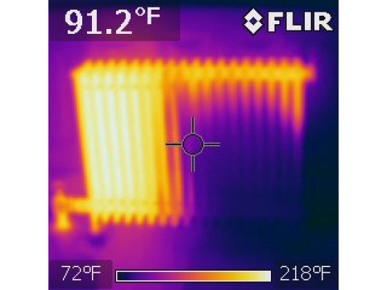

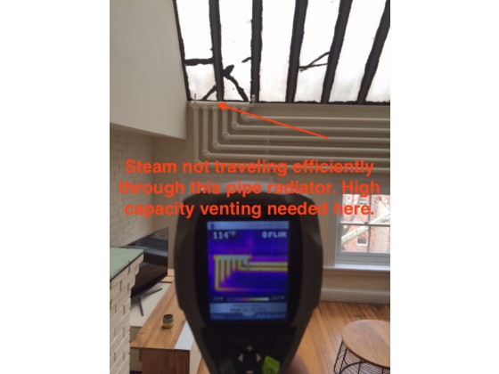

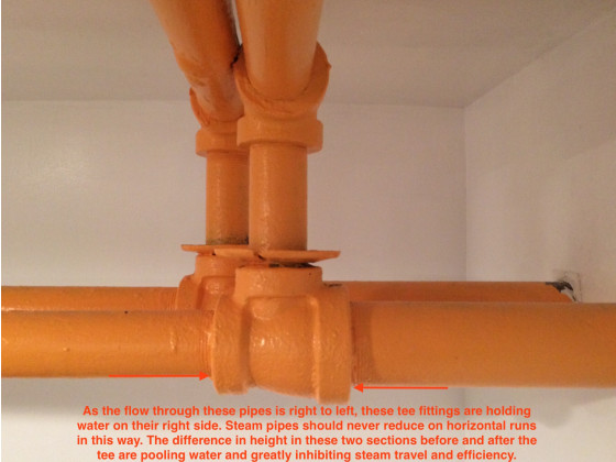

Working with a 100-year-old, 2-pipe steam heating system, uncover and resolve the causes of the persistent banging noises, radiator hissing, impossibly high fuel costs, and heating imbalance throughout the building.
Approach
Working with longtime friend and mentor, Dan Holohan, we determined the old water line of the system which changed when the building converted from boilers to Con Edison municipal steam production sometime in the 1980s. This change in water level exposed many of the previous purposefully submerged portions of piping and allowed pressurized steam to get into areas of the gravity return piping which in turn prevented the steam from traveling effectively to the various rooms in the building. We developed a system to recreate that original water line and re-establish a barrier between the pressurized and non-pressurized portions of this expertly engineered old system. The difference in pressure between these two is what makes steam move.
