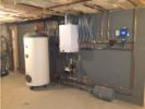

Case Study
Large Renovation Project
Challenge
A 1350 sq ft ranch was undergoing total renovation along with doubling the square footage. Approximately 2750 sq ft of 'in floor' radiant installed with virtually no pipes below the floor joists. Careful consideration was placed into future means of alternative energy usage- as in the "Primary Loop" can accept additional heating plants down the road such as an oil boiler or a geothermal water to water heat pump, or even solar.
Approach
We methodically and diligently planned routes and drilled hundreds of small-diameter holes through the old and new construction to install the new radiant floor heating system, and built the 'wall' that accommodates all of the newly installed (and future) hydronic heat piping
Solution
We chose the Viessmann Vitodens 100 because of its simplicity and durability. The radiant system is operated by Tekmar, so it (the radiant system) is completely independent of the boiler. An 80 gallon Stiebel Eltron water heater was installed to handle the larger mater bathroom whirl-pool tub. Grundfoss Alpha circulators were installed to keep wattage to a minimum, and the Grundfos UP10 was installed to circulate hot water to the original-location bathroom in the original structure
