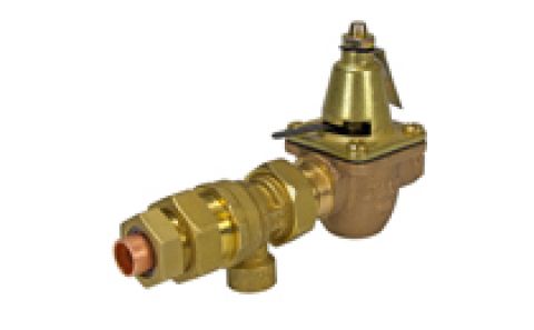

Taco Comfort Solutions has expanded its line of boiler feed valves to provide contractors with a greater number of choices while also improving safety, function and convenience.
The new Taco brass boiler feed and dual check backflow preventer with atmospheric vent is available as a combination unit, or the boiler feed valve and backflow preventer can each be purchased separately.
Designed for use in hydronic heating systems, the combination unit prevents heating system water from flowing back into the supply water piping if supply pressure falls below heating system pressure. It also offers simple pressure setting adjustment between 10 and 25 psi which is separate from the exclusive, lockable fast fill lever.
This unit provides installers with a convenient, complete solution for new systems or as a seamless replacement for units in the field.
The combination valve is available in ½-inch cast iron union sweat or union NPT feed valve with a brass backflow as well as ½-inch and ¾-inch brass union sweat or union NPT feed valve with a brass backflow. The backflow preventer, if purchased separately, is available in ½-inch and ¾-inch union sweat or union NPT.
Taco now also offers brass boiler feed valves in ½-inch and ¾-inch union sweat or union NPT.
