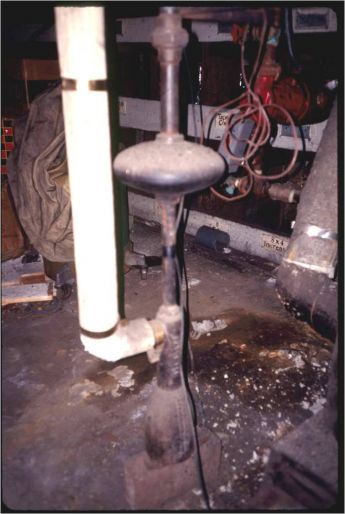

One of my more-memorable mistakes was standing next to Dave Nelsen (may he rest in peace) in the basement of an antique Long Island mansion as he tipped over a Honeywell Heat Generator and spilled about a pint of mercury onto the rich guy's floor.
Dave and I were of an age where neither of us knew what a Honeywell Heat Generator was, and Dave, in what I suppose was a search for instant knowledge, first shook the evil thing.
"Something's sloshing around in there," he said. "Must be sludge.”
And then he tipped it over to dump what wasn’t sludge.
“Ah, crap!" he said.
Now this happened a long time ago, well before we were all terrified of that shiny liquid metal. Mercury was in our toys when we were children, and our science teachers let us play with it on our desks. It was a jolly liquid that conducts electricity. It was in our thermostats and thermometers and everyone loved it. What could be wrong with mercury? Dave and I were more concerned about the mess. Who knew it was out to kill us all?
We scooped up the tiny globs with pieces of cardboard and a shop vac and put it out of our minds.
Lesson learned: Don't tip a Honeywell Heat Generator.
I did some digging in the library after that day and learned that Mark Honeywell invented his Heat Generator to compete with the folks who were selling steam heat. Mark Honeywell was a serious hot-water guy, and those steamfitters must have been getting under his skin because their systems ran hotter than gravity-hot-water systems and were less expensive to install. The Heat Generator was a simple device with just one moving part, that being the pint or so of mercury.
He used a pipe within a pipe that dipped into the mercury pot to separate the system water from the water in the attic-mounted, open expansion tank. He could then run the hot water up to about 250 degrees F., while still having a system that was open to the atmosphere. The super-hot water would circulate much faster, and that was important in the days before Homer Thrush invented the circulator. Mark Honeywell had come up with a brilliant device, and upon that rock he built his church.
So years later, we still find these mercury-filled time bombs in basements and they continue to tempt the sad souls of the heating trade.
I have come to accept the wisdom of this simple rule: If you're staring at an old device and you don't know what it is, put your hands in your pockets and back away from the thing.

Care to guess where the mercury had come from? Right! A Honeywell Heat Generator had once served this house. It sat in the attic with the open expansion tank, just waiting for the 1970s to arrive along with a heating contractor who would convert the gravity system to a pumped system. And because this contractor had not gone to the library to study, and because he did not know what he was looking at, and because he did not put his hands in his pockets and back away from the thing, he did what Dave Nelsen and I did when we were in our own Age of Ignorance.
He tipped the darn thing and gravity did the rest. Oh, and he didn't bother with the cardboard and the shop vac. He just let it all soak into the kitchen ceiling. Hey, it's just mercury, right?
