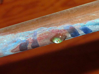

And there are other nasty things under our houses, which brings us to the copper tubing, which is failing in lots of houses. No one knows for sure why this is happening.
In our house, this one cold-water line, installed in 1991 when we added a dormer, failed three times, and in the exact same spot. It grew these insidious pinholes right in the middle of the pipe and nowhere near a fitting. Water dripped slowly down onto our kitchen ceiling, causing the cabinets to come loose.
We gutted the ceiling when we had the kitchen rebuilt and we saw even more pinholes. All of that copper is gone now, replaced by PEX.
But here’s the thing: In our house, the problem was only on the cold-water lines, and only on the copper tubing installed in 1991. The original copper, installed in 1950 was fine, and there’s never been a problem with the copper baseboard or the copper tubing in our heating system.
So bad batch of copper? No one knows. The problem runs rampant throughout the town and not just on tubing that’s from the ‘90s. And it’s not stray electrical current. I know it’s not because we had that looked into and took measures to ensure that this wasn’t the cause. The pinholes just laughed at our efforts. It’s not an electrical thing.
It’s also showing up in neighboring towns now, and no one can figure out why. Officials speculate that it may be the water treatments they’re using to deal with the contaminated plume under our houses. The stuff they were adding was making the water less alkaline and more acidic, so they’re now adding lime to the mix, which should bring the pH level back to where it was in the ‘80s when the copper was fine, but they say it will take quite some time before we’ll know if this works.
Adding to this mystery is this: None of the outside, copper-service lines are getting pinholes. It’s only the pipes inside the houses, and despite what we’ve experienced, 70% of the leaks are on domestic-hot-water lines, not cold-water lines.
