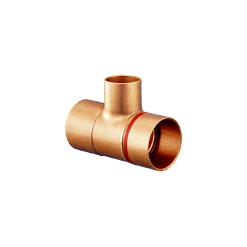

I learned about Monoflo systems and primary-secondary pumping, the importance of the point of no pressure and system balance and early radiant heating systems with copper pipes. I learned that we call centrifugal pumps “circulators” when they’re in closed systems because that’s exactly what they do, and that they often wind up on the return side of the boiler because that’s where the water is coolest. I learned how important this was years ago when mechanical seals couldn’t take very high temperatures, and that all of this was happening at a time when the hot water industry was tinkering with high-temperature systems. This, to compete with steam.
I learned a lot of tradition from the rep, and a lot of hydronic history. I learned how to think like an American heating guy.
I was in Germany talking to an engineer once. The subject of Monoflo tees came up and I was pretty proud of what I knew. He had never seen such tees with their tight internal cones and I was explaining how we do things in America. The man listened and then got furious. He said that we were designing fixed and permanent pressure drops into our American systems and that meant that we had to use larger-than-required circulators. We were wasting the world’s electricity. I tried to explain that this was how the early hydronics industry competed with the one-pipe-steam folks, but he told me that we were irresponsible. He really was furious. It was a heck of a way to start a relationship.

The engineer got angry with me because I was looking at his panel radiators and asking how the water flowed into them. They were set up on a one-pipe system. I couldn’t see how the water made it from the pipe into the radiator. That’s when I asked if they had some sort of Monoflo tee going on inside the pipes. I made my sketch.
He told me that the water flowed into the panel radiators because the pressure drop across the pipe was greater than it was through the panel radiator. The tees were spaced widely – the width of the panel radiator. Oh.
Gil Carlson used to say, “When two piping circuits are interconnected, flow in one will cause flow in the other, to a degree depending upon the pressure drop in the piping common to both.” That’s the basis of the Monoflo tee, and also of primary-secondary pumping.
