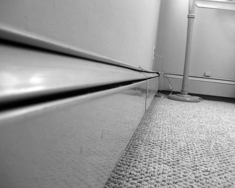

Too Much Baseboard?
If a house has too much baseboard (and most do), that could be good news for you when you're selling a boiler because you'll get to run that boiler at a lower temperature, which opens the door to a modulating/condensing unit. We often turn our backs on mod-cons when there's baseboard because we figure the flue gases won't condense. If there's beaucoup baseboard, though, those gases may be loving it because it's similar to those old systems that have high-volume radiators. The other guy's mistake just might work in your favor if you're smart, but watch out for that maximum run of 70 feet on any one loop.
Baseboard Tidbits
One room in the middle of a baseboard loop system wouldn't heat. How come? The installer had turned that room's baseboard element 90 degrees before soldering, effectively blocking the air passages. Gosh.
Standard baseboard may not be the best choice for bathrooms where there is moisture (of all sorts) flying through the air. Steel will rust and be unsightly, even though it's factory-painted. Go with a non-ferrous type of cover for the can.
If you're getting expansion/contraction noises, check those plastic runners under the elements, as well as the size of the holes where the pipes move between rooms. Pipes grow wide as well as long when heated.
