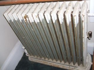

First things first. Before the 1920s, most steam contractors used cast-iron, column-type radiators. Those are the free-standing ones with the real wide sections. Column radiators were perfect for steam heating because they had a lot of internal space and they allowed the steam to rise up and displace the heavier air.
In the case of one-pipe steam, the air worked its way out of the radiator air vent. With two-pipe, the air escaped through the steam trap (or that old Vapor gizmo) and left the system through a vent somewhere down the main. Having a radiator with lots of internal space also allowed room for the condensate to get out of the way of the steam.

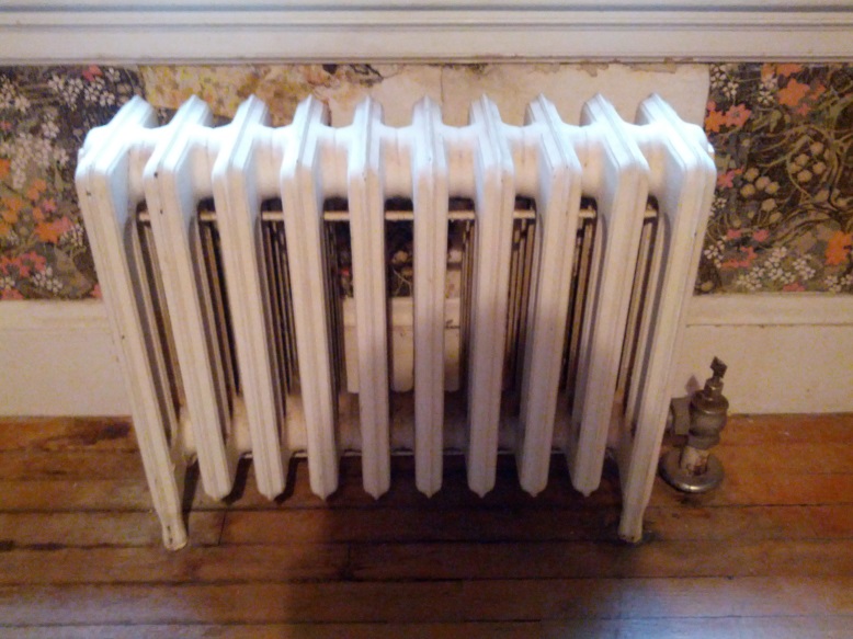

steam column radiator
The trouble with those old column radiators, though, is that their makers never intended for them to be used with hot water. Those individual radiator sections aren't connected across the top, and that presents a challenge with water. You have to look real close to notice this on those old radiators, and it's the very first thing you should look for when you're considering a conversion from steam to hot water. If you don't see those top push nipples, the conversion isn't going to be very easy - or practical. Water won't flow well through a sectional radiator that's not connected across the top. To make it work, you'd have to drill and tap each section and install some sort of air vent all the way across the top. Or, if you have a LOT of patience, you can wait for the system water to absorb the air and move it to the air separator. This could take months.

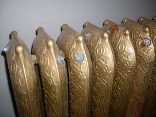

steam radiator with screws to release air
Oh, and here's what your gorgeous radiator might look like after you're done putting screws into it to vent the air.
After the 1920s, steamfitters began using cast-iron, tube-type radiators (the ones with the thin sections). These were actually hot water radiators, but they also worked well on steam systems. Building owners preferred them because they were nicer to look at. Tube-type radiators do have push nipples across the top of the sections, so if that's what you have, you can move on to the next step.

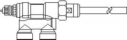

Danfoss conversion valve
Another option if you have one-pipe steam is to look into this unique valve from Danfoss. It works best with radiators that have push nipples across both the bottom and the top of the sections. You'll still need to run that second pipe (perhaps with PEX tubing?) but you'll just need one connection at each radiator, and you'll have the advantage of that thermostatic radiator valve.
