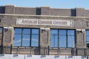

American Radiator Company

At the turn of the 20th Century, the American Radiator Company was the Big Cheese when it came to hydronic heating. Most buildings around the world that had heating in those days had American Radiators and Ideal boilers. The company published a monthly magazine called the Ideal Heating Journal that usually featured a photo of a building on the cover with a proud caption that told how this building was heated with their boilers and their radiators. And we’re talking buildings like The White House and the Vatican here. These were serious people.
And because of that, the budding hydronics industry looked to the American Radiator Company for leadership and research. The company built a facility in Buffalo, NY (cold enough for you?) that they called the Institute of Thermal Research. And isn’t that a grand name? This is where they tested their radiators under real-world conditions and figured out (to a ridiculously accurate degree) how much heat those radiators will give off. Here’s how they did that:
