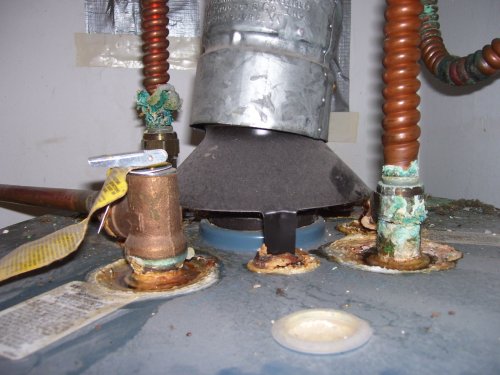

Prevent explosions
All tanks must be equipped with a new temperature and pressure (T&P) relief valve when installed. The purpose of the T&P is to protect the tank from excessive pressure and prevent it from ever reaching the boiling point. If a tank heated above 212 degrees ruptures, it will explode with amazing power: a 40-gallon heater can level a house.
Avoid the possibility of an explosion by making sure the heater's T&P valve is functioning. (They can clog and be unable to release water.) Test the relief valve at least yearly. Lift the test lever and allow it to snap back down. If little or no water runs while it's open or if it leaks after you close it, replace it. (In our hard-water area, about a quarter of the valves fail this test.) It may be an annoyance to replace relief valves, but that's nothing compared to the potential for problems caused by not replacing them.
Check also to be sure the drain line is piped from the T&P to a safe location. Otherwise, someone could get sprayed with boiling water while the valve is doing its job.

Eliminate carbon monoxide danger.
On fuel-fired heaters, blankets can slip and prevent adequate combustion air from getting to the burner, or they can interfere with drafting. This results in poor combustion and can produce carbon monoxide. Poor air supply can cause a back draft. Look for evidence such as soot around the combustion chamber door or rusting at the draft hood on top of the tank. Carbon monoxide can also get into the house if a heater's vent is not correctly hooked up or if it's corroded through. A carbon monoxide detector may help in finding problems. Use qualified help to deal with carbon monoxide problems.
