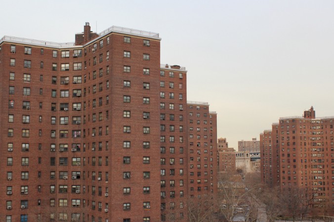

In another part of New York City there's a housing project that stretches for blocks. This is a place where thousands of people live together as total strangers. New York City heats these buildings with hot water, and here too, they use a steam boiler and a steam-to-water heat exchanger. How come? Because the buildings are very tall and high-pressure hot water boilers can get pretty pricey.
Besides, in New York City, you need special people to look after high-pressure boilers. The engineers could have used steam, but few people want to heat directly with steam nowadays so they did it with a heat exchanger. That also kept the guys in the boiler room happy.
What the engineers wound up with in this case were a couple of boilers that were as big as two-story buildings and a steam-to-water heat exchanger that looks like a Greyhound bus.
I visited the boiler room on a frigid January morning when the thousands of strangers who live in the connected high-rise buildings were freezing and screaming. The water flowing through their radiators wouldn't get any hotter than 150-degrees, which just doesn't get the job done in January.
Now, before I go any further, I have to tell you how this system works:
The boiler sends steam to the heat exchanger, which hangs in space like a steel dirigible. Condensate from the heat exchanger's shell drips into the return side of the boiler without benefit of a boiler-feed pump. This is okay because you don't need a boiler-feed pump when your heat exchanger is that close to the boiler and your boiler pressure is only 2 psi or so. All you need is gravity, and they had plenty of that.

Everything worked as it should on the day I was there, except the 150-degree water was too cool to heat human buildings. Nevertheless, a small army of men in overalls went from apartment to apartment bleeding radiators. They didn't get any air when they bled those radiators, but that didn't stop them from bleeding. They bled because that's what people in overalls do when there's no heat. They bleed.
When I got there, the boiler room was filled with official-looking guys. Each had an electronic thermometer and a clipboard. These folks were busy probing the pipes and taking temperatures here and there. After a few hours of data collection, this is what they decided: The water, at 150 degrees, was too cool to heat human beings on that particular day.
Their solution was to raise the steam pressure. They raised the steam pressure because that's what people with clipboards do when there is no heat. They had it up to 13-psig when I arrived, and the only thing that kept them from pushing it higher was the 15-psig relief valve setting. They had, you see, reached the limits of this particular technology.

They still weren't buying it so I asked one of the boiler room guys if he would take a wrench and clamber up on top of the big boiler. When he got there, I shined my flashlight on this union that was on the heat exchanger's condensate drain line. I told him to loosen it. He did, and a ferocious rush of air came spewing out of the exchanger's shell. Steam shot across the heat exchanger and the water temperature shot up almost instantly.
"But we never shut these boilers off," the guy with the clipboard insisted. And for the first time, he turned to one of the boiler room guys for confirmation. To this point, no one had spoken to any of the boiler room guys, so naturally, they hadn't offered any information. It's like that in Gotham City. Clipboard guys hardly every talk to boiler room guys. And vice versa, of course.
"You ever shut this boiler off?" the clipboard guy asked.
"We shut it off for a half-hour last week to do a repair." came the answer.
And that's all it took to fill the shell with air. A lousy half-hour. The vacuum breaker opened and sucked in great gobs of air, and once it got in, there was no way for it to get out.
I had them add a main vent to the discharge side of the shell. It should have been in there from the start, but someone in the green room had missed that small detail.
