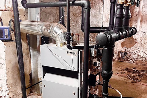

Subdural posed a question on The Wall at HeatingHelp.com in the Strictly Steam section, where some of the sharpest knives in the drawer post every day. The question was about a drop-header, and if you don’t know what that is I’ll do my best to help you understand.
Back in the day, the steam boilers were much larger than they are now. They had very wide sections so the steam could rise up through the water without causing a lot of turbulence on the surface. They also had much larger steam-disengaging spaces so the steam could leave the liquid water behind as it headed for the radiators. And those wide boiler sections were able to accommodate bigger pipes that rose to the horizontal steam header. That was important because the wider pipes kept the steam’s velocity low as it left the boiler. The faster steam goes, the more likely it is to lift the liquid water with it, and once that water gets into the pipes, it causes the steam to condense. That means you get less steam reaching the radiators, which leads to higher fuel bills, and more liquid water in the mains, which leads to water hammer.
But boiler manufacturers really didn’t have much choice as things evolved. The first oil embargo in the early ‘70s caused the government to mandate higher efficiencies for boilers. The only way to do that was to reduce the size of the boilers, and that was a bad thing because, with the higher efficiency, came more narrow boiler sections and smaller pipes rising to the boiler header. High-velocity steam was the result, and much of the liquid water began to leave the boilers.
It took a long time for the trade to realize what was going on, and the more steam-savvy contractors turned to a Dead Men trick called a drop-header. This is a near-boiler configuration where you take (ideally) two risers out of the boiler and bring them up as high as you can, given the geometry of your basement. From there, the drop-header piping turns horizontal and then vertical again, dropping down to the header, which is now close to the top of the boiler. Your take-offs to the steam mains leave from the top of the header and the end of that header drops further to become the header-drip/equalizer. Done properly, a drop-header does a magnificent job of keeping the liquid water in the boiler, which leads to much drier steam. Dry steam heats the building more quickly, saves fuel, and everyone is happy.
Subdural (a Wallie nickname) is a homeowner, not a heating professional. Steam heating has a way of grabbing some people by the lapels and making them want to do more of it because it truly is both an art, and a test of a person’s piping skills. It grabbed Subdural and didn’t let go.
Subdural uploaded a hand-drawn diagram of all the components needed to build the drop header that would serve their family. The Wallies commented on it, making suggestions that would improve the final product. From there the questions and answers turned toward who sized the new boiler. We learned that the supply house had said that it must be the same size as the one it was replacing. This may or may not be correct since oversizing steam boilers in America is somewhat of a national sport. The chat went back and forth for a few days and I was gaining more and more respect for Subdural. This person knew how to ask very good questions, listen, and take the advice offered.
Months went by and Subdural returned to post photos of the homeowner-installed, near-boiler piping. It was practically perfect. And I say “practically” because heating people will always find something in the other person’s job photo to correct, even if that correction wouldn’t make a bit of difference. We’re like that; we pick nits.
But I didn’t pick. I just smiled and congratulated Subdural because I was looking at work that was as good as anything I have ever seen when it comes to steam heating.
Another photo appeared and this one had a woman in it. She was holding a long wrench and the business end was attached to one of the risers to the boiler’s drop-header.
“Thank you for all the help,” Subdural wrote. “The build went great. It’s up and running and I appreciate all the help. If i missed anything, or there are any upgrades, please tell me. The system is working fine - no bangs, no leaks, and the skimming went well. Oh, and I figured if you knew I was a woman the advice would have been different. But I did make this build sexy.”
