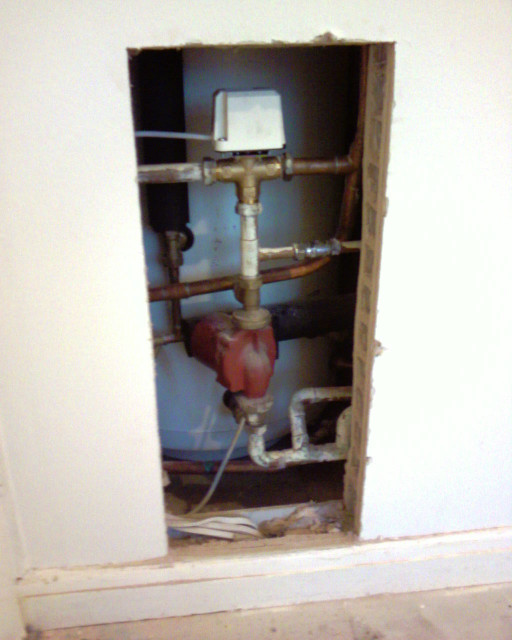

Do you know why they're not thinking about the circulators? Over there, most of the circulators are hiding in cupboards, or inside wall-hung boilers. They're using plenty of energy, but they're hiding while doing so. Out of sight, out of mind.
Now think about the circulators that are hiding all over the U.S., and how many of those circulators are older than your parents?
Folks over here (and over there) will probably replace all their light bulbs, the fridge, the washer, and the dryer before they start thinking about all those old circulators down in the basement – the ones that are hiding in the dark.
