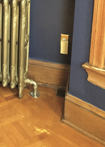

The owner called this summer and requested a service call. One of his radiators was leaking, causing the hardwood floor to buckle as well as the plaster wall to stain, pop and bubble. The drywall ceiling below was damaged as well. Brian quickly determined the cause of the problem. It was not a leaking radiator. The leak was from the hydronic piping in the wall.

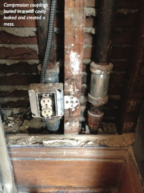

The owner’s contractor opened up the plaster wall exposing the surprise. Dresser Couplings were used to connect the newer copper mains in the basement to the old steel risers. These are a type of compression coupling. I have seen them used on gas piping and on the fill and vent piping on oil tanks. I have never seen them used on hydronic piping. In this case, they leaked in the walls and created a mess. Since this occurred back in June, Brian drained the system and shut it down while we came up with a solution.

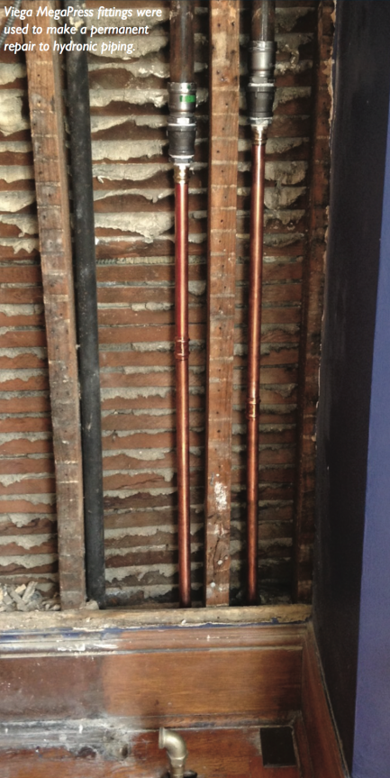

Brian came up with what I thought was a brilliant solution. He cut the risers square with an angle grinder. He then cleaned up the raw steel pipe with a file and a champfer tool. He cleaned and sanded the pipe to bare metal. He used Viega MegaPress steel fitting to transition from 1-1/2 inch steel pipe to 1 inch copper. The MegaPress fitting slips over the bare steel pipe. A press tool with the correct jaws then applies 35,000 PSI of pressure on the fitting creating a tight, permanent connection. He completed the repair by tying into the copper mains in the basement using Viega Pro-Press copper fittings.
Viega MegaPress fittings
Brian’s solution created a solid, permanent repair to the hydronic piping with minimal collateral damage to adjacent floors, walls and finishes. The press fitting technology also avoided brazing and soldering in tight wall and ceiling cavities around dry, 100-year-old framing. Once the piping repair was completed and the wall was patched and painted, you would never even know we were there.

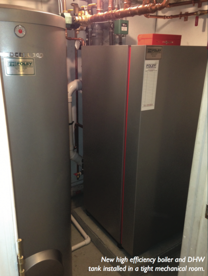

The client was so impressed with Brian’s skill and professionalism in making this repair, he decided it was time to upgrade the heating system. In September, Brian removed the 40-year-old boiler and unreliable water heater. The boiler room was renovated with masonry repair, new walls, and a poured concrete boiler housekeeping pad. The floor was finished with epoxy paint. This is my kind of boiler room!
Brian installed a new 95 percent AFUE modulating, condensing gas boiler and an 80-gallon stainless steel indirect water heater. All of the zone controls and boiler specialties were replaced as well. Space was tight but Brian got it all to fit. Since this was a row house with two party walls, boiler venting was a challenge. There was no way to vent to an outside wall. Instead, a Centrotherm PPS flexible liner kit was dropped down the existing chimney flue and connected to the boiler to resolve the venting issue.
