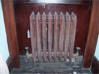

So the oldest engineer in the State of New York and I walked upstairs and looked at the heating system in the neighbor’s space. This is what used to be in the new tenant’s space. One look was all it took to tell us what we had here. The tip-off was the size of the supply and return risers. On most two-pipe steam systems, you’ll find big supply risers (because low-pressure steam is big), and small return risers (because condensate is small). There might be, say, a 1-1/4-inch supply and a half-inch return. Here, we had a 1-1/2-inch supply and a 1-1/4-inch return at each radiator. There was also a one-pipe-steam air vent on the return side of each radiator. There were no air vents on the modern, steel-panel radiators, of course. They had thermostatic radiator traps and thermostatic radiator valves. Modern stuff. None of it worked, but it looked marvelous.
The oldest engineer in the United States of America smiled at me and I smiled back. We knew that what we had here was a two-pipe, air-vent system. That’s why the new tenants with their newly modernized portion of the system had no heat.
There was a time in American Heating History when they didn’t use thermostatic radiator traps. They didn’t use these devices because no one had invented them yet; and you cannot install what has not been invented. This lack of traps, however, didn’t stop the Dead Men from installing steam heat. They just put in these two-pipe, air-vent systems, which look remarkably like two-pipe, direct-return hot-water systems.
The steam leaves the boiler and heads up into the building. It favors the supply lines, of course, because these are usually larger than the return lines by at least one size. Steam follows the path of least resistance. The Dead Men put an angle valve on each side of every radiator so that tenants could shut off the heat if it got too warm. The air left the radiators through the one-pipe-steam air vents. The steam heated the radiators, and the condensate dribbled down the return lines. The steam flowed into the return lines along with the condensate because there was nothing there to stop it. After a while, there was steam everywhere, and that was perfectly normal for this system. And since there were so few moving parts, these systems lasted for as long as the building stood.
But then the consulting engineer came along and decided that he could put a party hat on the elephant, while leaving the rest of its body naked. He added the traps to a system that’s not supposed to have traps because there’s supposed to be steam in the returns. And because of that, the new thermostatic radiator traps shut, and stayed shut. He got rid of the air vents on the radiators (even though they were supposed to be there), so the air had no way out of the system. And he added thermostatic radiator valves, which then stayed open because the rooms were as cold as Siberia. Steam couldn’t enter the radiators because air couldn’t leave. And if steam did enter the radiators, the condensate would have no way of leaving the radiators because the steam in the return kept the traps closed.
