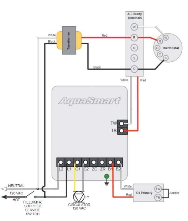

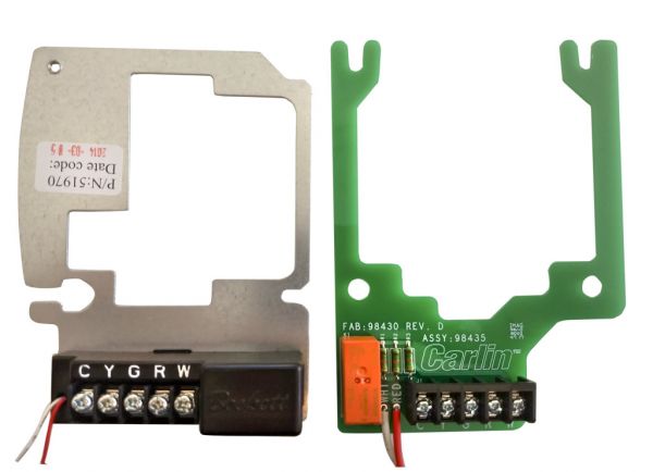

Let’s assume we’re working on a single zone hot water system and have a spare wire or have run a third wire to the boiler. Now what do we do? We get either a Beckett AC ready kit or Carlin Koolkit.
Why do we need a cooling device on a hot water boiler? Both of these are made to enable a modern oil primary to replace an 8184M and contain a transformer, relay and terminal strip—just what we need to provide a constant 24V power supply and switch for a wifi thermostat in an easy to install format! As an aside, if the job happens to have an older primary control, this would be a perfect time to upgrade to an electronic primary with diagnostic capability.
Install the AC kit per the manufacturer’s instructions; if there is not constant 120V power to the primary control mounting box, you will have to run a wire to provide this. The easiest spot is the L1 terminal in boiler temperature control, assuming it is powered at all times and not broken by a limit switch or low water cutoff. You could also mount the transformer at the power source and run low voltage wire to the terminal strip. As long as the power is not interrupted by operating or limit controls, we don’t want our thermostat going blank every time the boiler is off on temperature!
Now the existing thermostat leads, as well as our common lead, go the terminal strip as in the diagram below and the wires from the AC kit relay go to the TT terminals on boiler temperature control where the thermostat leads were previously. We’re done!
