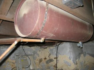

After the circulator came along in the late-1920s, the pipes got smaller and there was less expansion going on because there was less water in the system. The Dead Men abandoned those open expansion tanks in the attic (which were prone to freezing) in favor of closed steel compression tanks, which they usually hooked up to the butt end of a flow-control valve down in the basement. And for a time, there was peace in the valley.
But before long, the Dead Men leaned that, almost without exception, the compression tanks would lose their air cushions and fill with water. No one was quite sure why this was happening. They’d "solve" the problem by making it their habit to drain several gallons of water from every tank on every visit. This led to the common practice of draining all compression tanks, whether or not they needed draining. Generations were raised on this belief. If you see a steel compression tank, you drain it. Case closed.
And that’s how it was for years. But then the diaphragm tank arrived. Diaphragm tanks don’t need to be drained, but they do lose their air pressure over time. That’s because the diaphragm is made of rubber, and rubber is a semi-permeable membrane. Gasses will pass through the rubber and into the water at the rate of about 1-psi per year, which is why you should always check the air pressure before you throw away one of these tanks.
But let’s get back to those steel compression tanks for a minute. The air sits on the water like cheese on a pizza. When the circulator runs, it can’t add any water to the tank because the circulator is operating within a closed system. For the circulator to add water to the tank, the circulator would first have to remove some water from the pipes. And if it did that, there would be an empty space in the pipes where the water used to be, and that’s simply not possible. In a similar way, when the circulator runs, it can’t take any water out of the tank and put it into the pipes because the pipes are already filled with water, and for our purposes, water is not compressible. So follow this: Since the circulator can neither add nor remove water from that compression tank there won’t be any pumped flow in the line going up to that steel compression tank. With no flow, the water in the tank will be cooler than the water in the pipes because the water in the pipes is passing through the boiler.
Okay, now for a bit of science. Gasses will dissolve in liquids in proportion to the pressure and temperature of the liquid. That means that as water cools, it absorbs air. And when water gets hot, it releases that air. Now, since the water in the compression tank is relatively cool (compared to the water in the pipes), it will absorb some of the air that’s inside the compression tank. That’s only natural.
Here’s what happens next. The hot water in the pipes rises by buoyancy into the tank as the cold water in the tank sinks down into the pipes. These flows pass each other in the single pipe that connects the compression tank to the system piping. We call this "gravity circulation" and it has nothing at all to do with the circulator. It’s just a natural phenomenon. Now watch this. The air that gets absorbed up there in the tank eventually winds up in the piping because of this gravity circulation, and once that air-laden water comes up to temperature, the air gets released as bubbles. Those bubbles get pumped out to some radiator where they settle out of the flow because the water’s velocity out there in the system is usually less than it is closer to the circulator’s discharge. Someone winds up venting the radiator, and that lowers the system pressure. The fill valve senses this and opens, allowing fresh water to enter the system. That new, cold water goes up into the tank because that’s the only place that can accommodate it. Remember that the pipes are already filled with water.
So every time this happens, there’s a little less air in the compression tank, and a little more water. That’s how steel compression tanks get waterlogged. The way to prevent it is to use a special fitting that’s designed to stop gravity circulation between the tank and the system piping. Bell & Gossett Airtrol Tank Fitting is a good example of what I’m talking about. These things have been around for longer than I have and they work well. Sometimes, those "old-fashioned" devices deserve a second look, especially if you’re spending a lot of time draining steel compression tanks.
