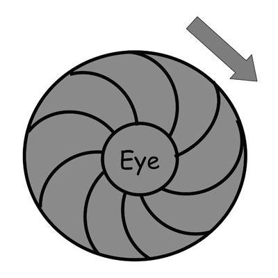

We call the circle at the center of an impeller the “eye.” Delta P-wise, it’s similar to the eye of a hurricane, but much friendlier. The impeller spins and creates centrifugal force. The water flows from the eye through the vanes of the impeller, creating a higher pressure at the tips of the vanes (which is also the outer edge of the impeller) and a lower pressure at the eye.
And there’s that Delta sister again (P). A difference in pressure between two points will always cause flow. You know that instinctively. You watch the weather report on TV. They talk about a low-pressure area moving in. You know it’s going to get windy because when there’s low-pressure anywhere, air will rush over to fill in the hole. Or think about a tornado. It’s a ridiculously violent version of an impeller.
circulator
The impeller spins the water and directs it toward the outlet of the circulator, which is always a bit narrower than the inlet of the circulator. Not sure if you ever noticed that but it’s true. Don’t look at the size of the flange; look at the shape of the waterways entering and leaving the impeller. The quickly moving water experiences centrifugal force and suddenly has to race through that narrow exit, and it speeds up as it does so. That’s what you’re seeing if you have gauges on the circulator.
