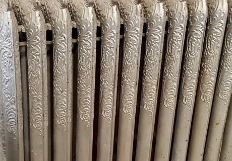

A guy I don’t know emailed me a question. I get a lot of that because I’m easy to find on the internet. He wanted to know if it’s true that all manufacturers stopped making cast-iron radiators back in the 1950s when I was watching “Howdy Doody.” He heard they were no longer available and hadn’t been for a very long time.
I wrote back and told him that this was not true, and that manufacturers continue to make and sell cast-iron radiators. They also still make cast-iron baseboard radiators. I included a link to one of the manufacturers’ product catalogs to prove my point. Radiators are alive and well.
He wrote back saying that he thought it was true that all manufacturers stopped making them in the ‘50s and that I was mistaken.
I responded again — mainly because I’m retired with too much time on my hands — but I was also curious as to how he had come to this conclusion, and in spite of the facts I had sent him.
“My friend lives in Southern California,” he wrote. “He told me that there are no cast-iron radiators there and there haven’t been any there since the manufacturers stopped making them in the ‘50s. It’s true.”
I explained that it is mostly warm in Southern California and that this was probably why his friend wasn’t seeing any cast-iron radiators there. Weather has an effect on the heating market. The warmer it is, the fewer radiators there are.
“My friend said there are none,” he wrote back. “He lives there.”
“Tell your friend to go to San Francisco,” I wrote. “There are cast-iron radiators there, and San Francisco is in California. My brother lives in Oakland, right next to San Francisco. He has cast-iron radiators and steam heat in his apartment building.”
“My friend says there aren’t any,” he answered. “I’m wondering why they stopped making them. What happened?”
I decided I didn’t have that much time on my hands and stopped writing to him. But that guy stays with me because of his persistence. He was on a mission and it’s often difficult to talk to people on a mission. Their minds are closed. Your facts mean nothing to them.
