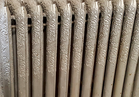

And then there was this other guy who had also made up his mind. He didn’t write to me. He posted his question on The Wall at HeatingHelp.com. I thought I could help. I should have known better.
“I live on the top floor of a New York City apartment building. Our apartment has five vertical, floor-to-ceiling pipe heaters. It’s not that they don’t heat the apartment properly; it’s that they make unbearable whistling sounds. We just moved in a couple of weeks ago and these things have woken me up practically every night I’ve been here. The release vents on the pipes take 15 to 20 minutes to empty whatever air is inside the pipes, which seems kind of long. The vents on each of them are Hoffman #41, with holes for the pipes that are 1/8-inch wide. Is that big enough for this type of line? And are these the building’s main lines? I suspect they are, as the landlord has said if I were to turn one of the vents off, the resulting radiators connected to it would turn off as well. Also, would a building of this size have a one- or a multi-pipe heating system? That question, admittedly, is a little out in left field, but it’s a curiosity of mine.
“But anyway, I want to try out a larger air release valve, such as a Gorton #2, or a Hoffman #75. Does that make sense here? Do I run the risk of water spraying out of the ventilation hole if it’s too big? When I suggested to my superintendent that he widen the hole (not knowing what a main line valve was or what, generally, I was talking about at the time), he said that would cause 400-degree water to spray everywhere and that these valves all come in just one size. I assume he means 1/8-inch. I don’t know if what he said regarding the water was true (though I think he inflated the temperature a bit), but seeing as how I now know his second statement was false, coupled with the general impression I have of this guy, I get the feeling that he doesn’t have much experience. So I guess my final question is this: Is it OK and safe to buy and then try connecting one of those other vents on my own?”
What he has is a typical setup in New York City. The pipefitters ran steam risers from floor to ceiling in tenement kitchens and bathrooms. The pipe typically rose five or six stories and it was the radiator for that room. Its output was this:
1 1/4” riser = .63 sq. ft. EDR per linear vertical foot
1 1/2” riser = .73 sq. ft. EDR per linear vertical foot
2” riser = .88 sq. ft. EDR per linear vertical foot
(One sq. ft. EDR = 240 Btu/h in a steam system.)
There’s only one vent on these risers and it’s almost always in the top-floor apartment. These vents often whistle on startup because the pipefitter drilled the pipe for 1/8-inch rather than install a tee. That saved a couple of bucks back in the day.
To stop the whistling air that’s trying to get out through the too-small hole, top-floor tenants often turn the air vent upside down. That keeps the air from venting because the vent’s float and pin fall by gravity into the vent’s hole. That stops the noise because it stops the venting. But it also stops the heat to the entire riser because if the air can’t get out, the steam can’t get in. Everyone on that riser loses their heat because the guy on the top floor doesn’t like the noise.
After getting complaints from the lower-floor tenants, the super will investigate and turn the vent back upright. As soon as he leaves, the tenant will turn the vent back over again.

“The size of the hole in the pipe is going to determine how much air leaves the air vent, no matter what size the air vent is,” I explained. “Your vent is the air-release point for the entire six floors of pipe radiators. I think you need a pro with tools that can increase the size of the hole to accommodate a vent with the correct venting capacity. He’ll need to add a tee of the proper size to do this. I also think the steam pressure in the building is probably much too high. Tell your super the water can’t be hotter than 212° F, and that it won’t splash out if the velocity of the air escaping is slower, as it should be.”

I wrote again. “The size of the hole in the pipe is what determines the venting rate. Think of it as a highway with all but one lane closed. The width of the road after the bottleneck doesn’t speed traffic through the bottleneck. You can only force so much air through a 1/8-inch hole.”
