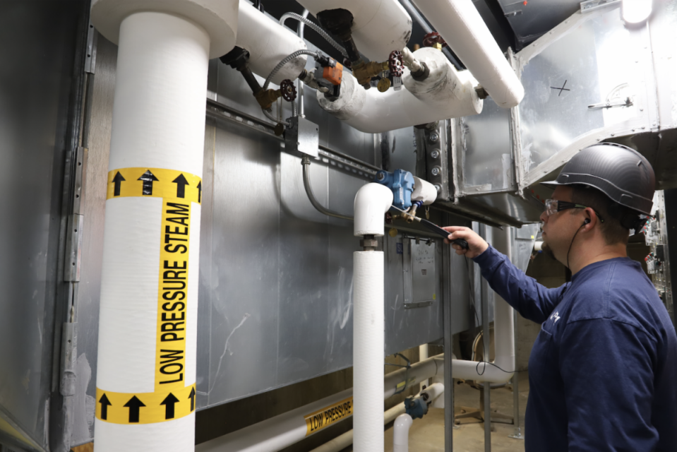

APM Steam experts conduct steam trap surveys to test and document operational status using ultrasound and temperature differentials. Survey data provides a complete trap inventory and extensive system information in a detailed report outlining findings and recommendations, a synopsis of results, and a return-on-investment calculation that compares replacement costs with losses associated with failed traps. The report also includes trap application problems and specific recommendations for trap and trap station improvements. With colder weather imminent, improving your steam system's efficiency becomes paramount. By identifying areas for improvement, APM Steam's surveys can lead to significant energy savings.
Throughout the survey, APM Steam field technicians evaluate elements surrounding the steam trap, including isolation valves, inlet strainers, strainer blowdown valves, outlet check valves, trap station bypasses, test valves, and sight glass flow indicators. The survey also evaluates all features of a properly working trap station that allows technicians to work on it safely without being exposed to live steam present in the system. These issues could prevent technicians from repairing without requiring a disruptive facility shutdown.
APM Steam’s steam trap surveys tag each trap with a sequentially numbered stainless-steel tag and a wire hanger, enabling the user to find any specific trap in their system quickly. Included in each survey is documentation of trap location, application, steam pressure, manufacturer, model, and technology. Pipe size and trap size, connection type, inlet and outlet temperature, and comments about existing installation are also documented. This detailed information helps set the stage for repairs by highlighting any access issues, confined space requirements, and need for a lift, as well as listing any other failed components or potential repair issues.
