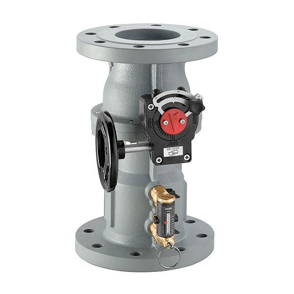

Caleffi Hydronic Solutions' popular 132 Series QUICKSETTER™ static balancing valve line has been expanded. The new flanged QUICKSETTER is used to balance fluid flow in hydronic heating or cooling distribution branch piping systems. The valve has ANSI 125 cast iron flanges for pipe sizes 2½”, 3” and 4” with adjustable flow ranges of 30 to 105 GPM, 38 to 148 GPM and 55 to 210 GPM respectively. An integral flowmeter with industry exclusive, nonwetted flow scale permits fast and easy circuit balancing without the need for differential pressure gauges and charts. A smooth hand wheel movement allows for high adjustment accuracy. The rotation indicator has a tamper resistance lock. The valve is cooling and heating rated from 14° to 230°F (-10° to 110 °C) and is glycol compatible (up to 50% concentration). Flowmeter isolation valves protect meter from debris and facilitate ease of meter removal and service.
